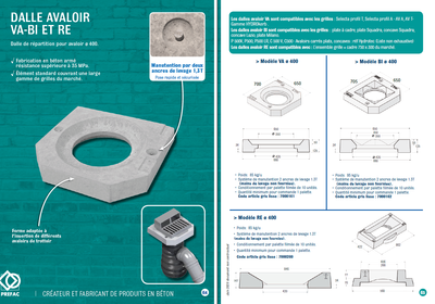

Hi everyone!
I'm working on a catalogue in InDesign (120 pages) and I came across something that I can't seem to figure it out.
When I'm working on my document, there's no problem at all. But when I export it (single pages), all the content moves a little, creating the following result (you can see a small part of the first page moving to the second one, and also the left margin of the first page being cut):
I don't understand what's happenning, since the result should be this one, but I can only achieve it when I export it facing pages:
I've worked on this project last year and everything was fine. This year I came back and it was like this. I though the file was corrupted or something so I created a new one saving the old one as .idml. But nothing seems to work.
Anyone has any idea of what the problem might be?
Thank you in advance.

Hi! It's a little better, but on the left margin there's still a cut. It's perceptible on the logo.
The right margin it's already done. I really don't understand what's the problem here.
Copy link to clipboard
Copied
Your logo is in the bleed area and will get trimmed—if you don’t want that to happen you’ll need to move it inside of the crop marks. The typical safe distance from the page trim is .25”.
Copied
I thought about that, but then I don't understand why the bottom part doesn't get trimmed as well, since it's outside as well, like this:
Copied
Looks like you are confusing the page margin guides with the page trim—the magenta guide is the margin and the black guide is the page trim:
