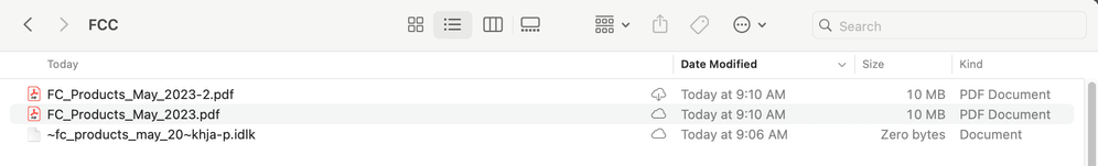

I'm having the same issue. I work on both a PC and Mac. I usually created the Indesign doc on my mac and save to google drive for desktop. The file looks fine when viewing on my Mac, but when I log onto my pc the pdf file is 0 kb or does not have the current version. I can copy the file from Macbook and paste into google drive on PC and it is fine. Here are some screen shots to show what's going on.
The first is from my Macbook showing the 2 pdf files in the Google drive folder.
The second screen shot is from my PC. Taken one minute later. Note the date modified column for both the Indesign file and PDF created out of Indesign "FC_Products_May_2023.pdf". The date is March 6, where on the Mac the date is March 13.
"FC_Products_May_2023-2.pdf" is the copied file.  "FC_Products_May_2023.pdf" is the pdf file created out of InDesign.  Macbook Screen Shot.pngPC - windows 10.png

Where's the one showing it as zero KB on the Windows machine? What if you create the PDF on Windows and then check it on the Mac?
Honestly, this strikes me as a Google Drive problem and quite possibly a configuration error. InDesign is the last place I'd be looking. And judging by the cloud icon, I'm guessing you have some kind of smart sync enabled. Turn it off!

Do you know where I can find the smart sync setting? Like are you refering to Creative Cloud settings? Google drive settings? Mac system settings-iCloud?
I fixed the zero kb pdf, so there wasn't an example. I recreated the issue and here are those screen shots. I see there is a cloud without the down arrow on the 0kb file. PC PDF test.pngpdf test on mac.png
