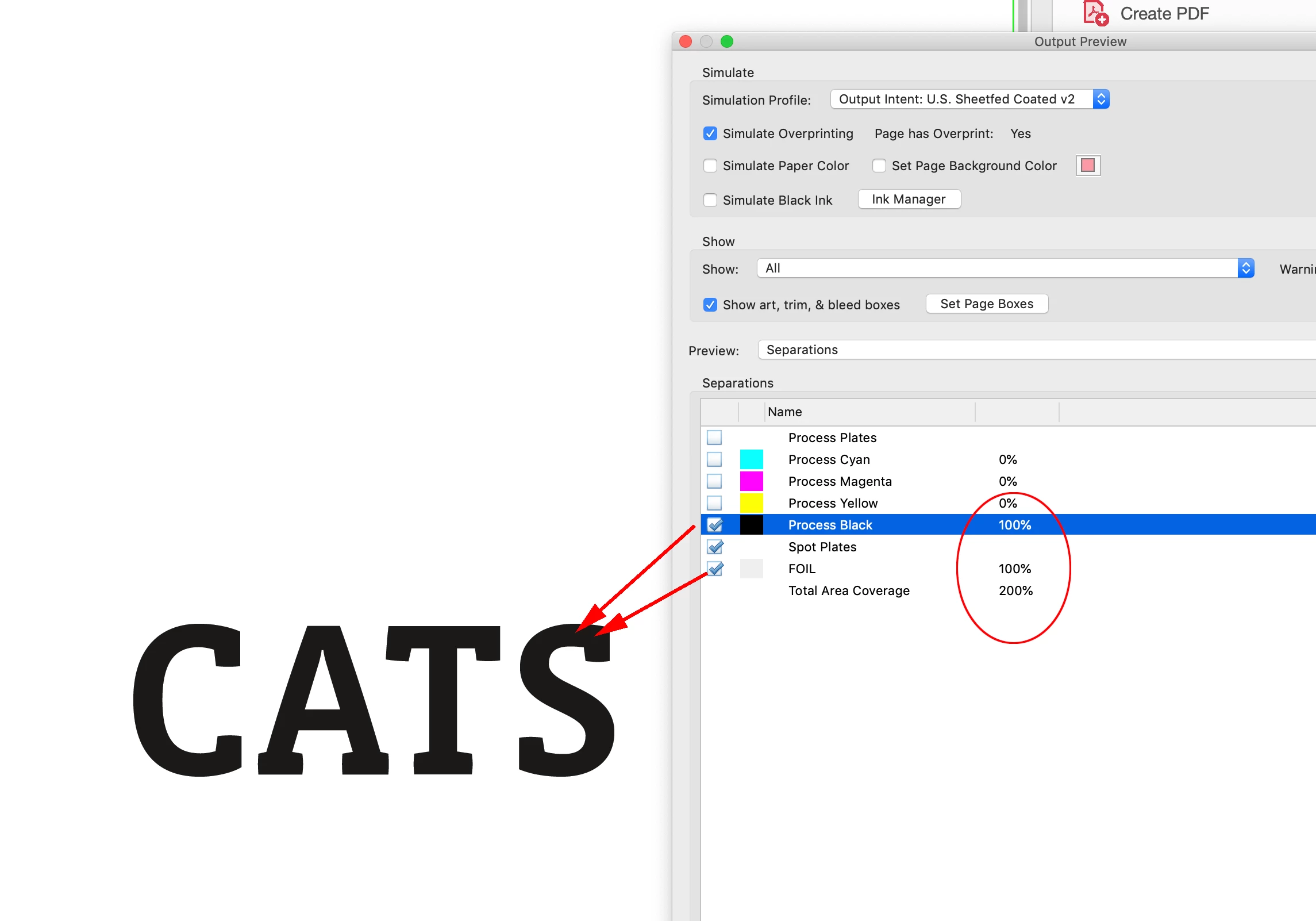

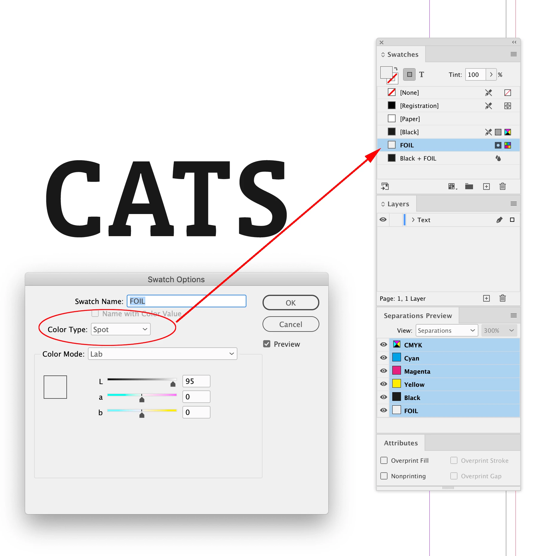

Hi @martag23036585 Typically foil or varnish plates are setup as Spot color separations with the Foil swatch Color Type spec’d as Spot. The PDF you posted is not doing that—it would output as 4-color to the process plates
You want the word cats outputting to both the Black plate and a Spot plate like this:

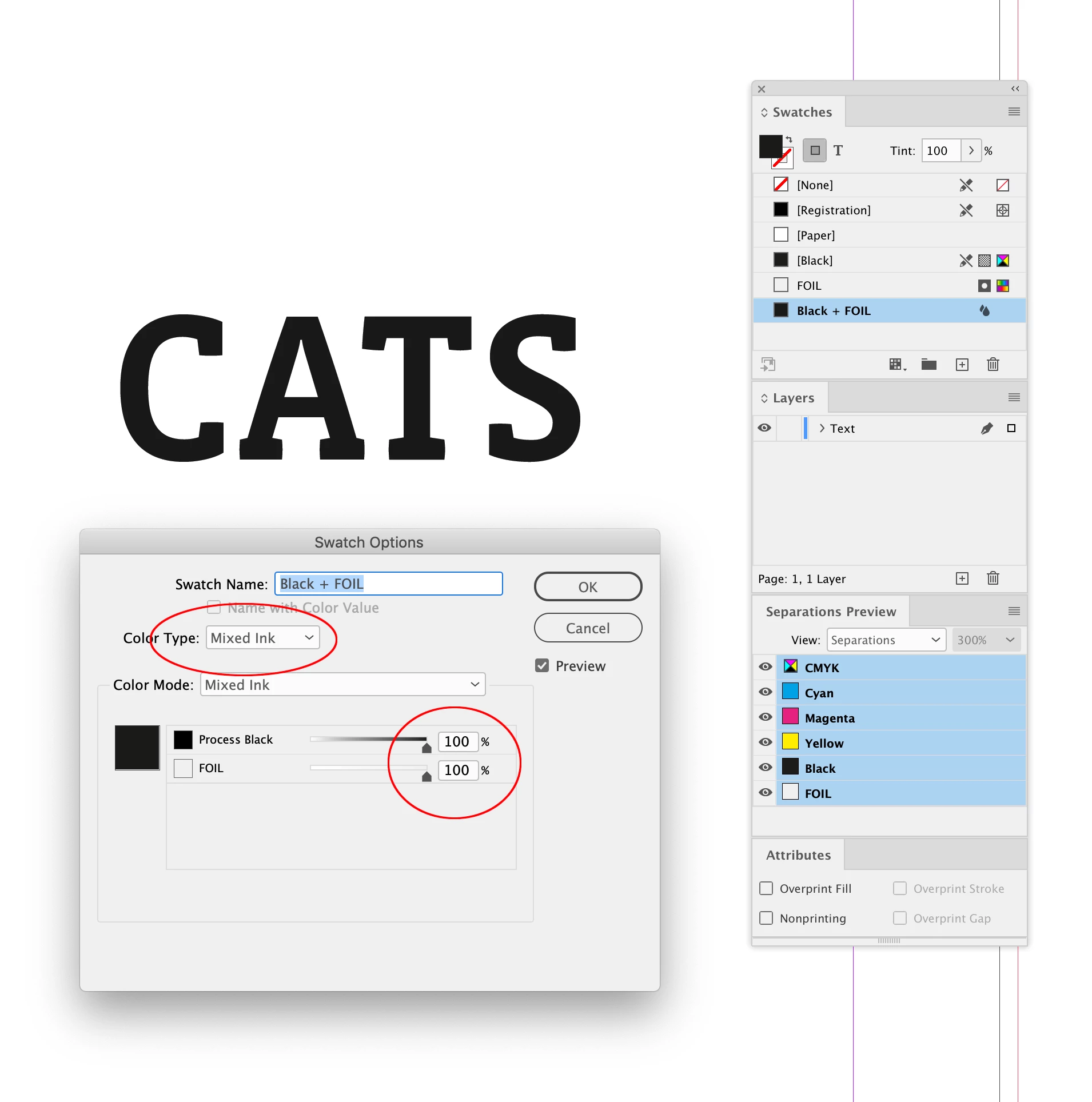

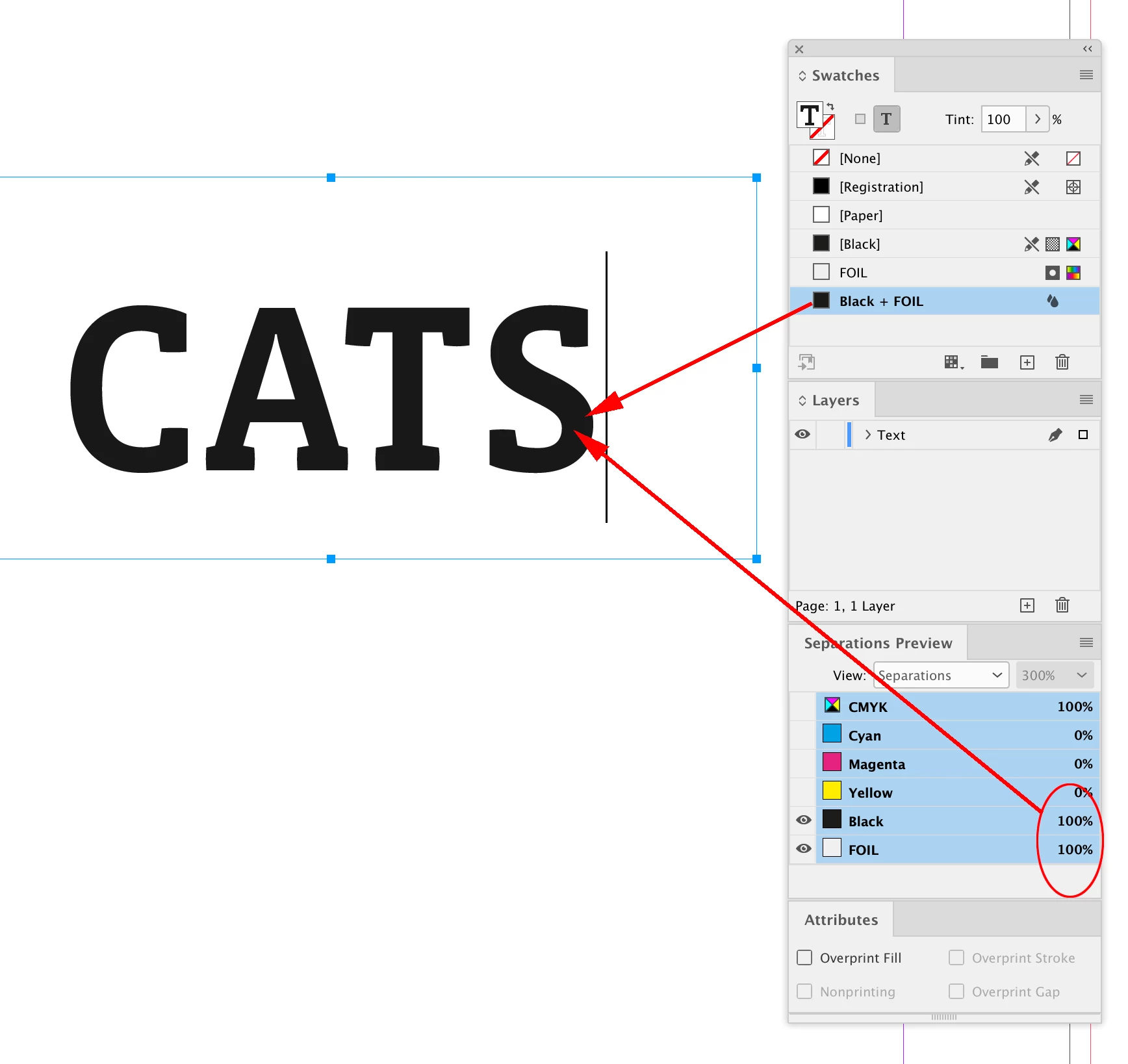

There are a number of ways to generate a foil or varnish separation, so you should talk to the printer.
FWIW, I setup a Foil Spot Swatch and Mixed Ink Swatch combining the [Black] and the Foil swatch in InDesign:
