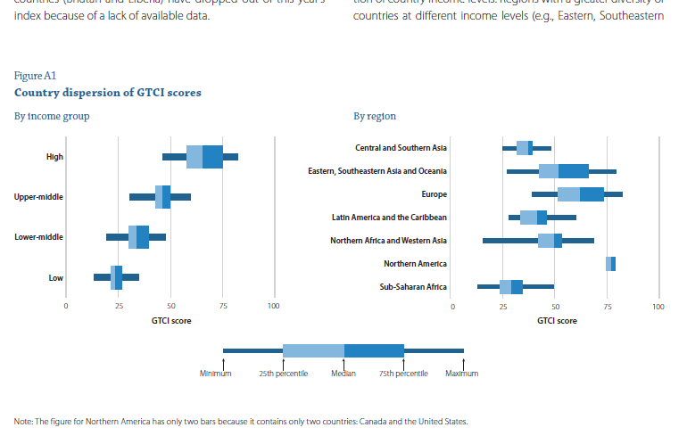

Screenshot from PDF: exported to PDF outside book
exported to PDF outside bookexported to PDF outside book
Screenshot from PDF: exported to PDF from book file. This is three separate .ai files. The readable type you see is live type on the page in ID.
exported to PDF from book fileexported to PDF from book file

Here's another example. This one's simpler. First, exported to PDF outside book file:
Next, exported to PDF from the book:
Figure number, title, and source are live type on the page in ID. The body of the figure (the three graphs) is one .ai file.

Still trying to figure this out: I tried opening in Illustrator a page from the PDF exported from the book file, cut out all the other stuff, and left the body of the figure. Then I released all the clipping masks and deleted the empty paths. What's left over is two images, 72 ppi images at that. Indesign is converting my precise vectors into crappy low res bitmaps.
