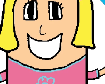

I am making a book in InDesign CC 2017.1 with illustrations from Photoshop.
When I place the photoshop file into the ID document, the image looks pixelated, but when I export it as a PDF, it looks fine.
I am viewing it with "High Quality Display" selected, but it doesn't help.
How do I get it so it looks like it will when I export it for print?
Here is a screenshot of the pixelated image...

From what I am hearing, it sounds like it is not a problem with my Photoshop or InDesign documents themselves, but it is just how InDesign renders my file, and it can't be fixed.Is this right? Should I just not worry about it? Is there a way so I can at least see my graphic without it being pixelated?
Thanks.
April 27, 2017
The part of the image that you see in InDesign (the preview) is built from the image, although it isn't actually the image itself. If you really want it to be more clear in InDesign, you could lower the resolution in Photoshop without resampling (very important point) to something like 100ppi. That will necessitate it being scaled down in InDesign to the size you need it to be. The larger the image physically, the more data in the preview, so once it's scaled down, it will be a bit sharper. Make sure you don't resample in Photoshop, or you will be removing data (and detail) from your file. Larger previews will make your InDesign file a bit larger in file size, but if it's just a few images, it probably won't be a problem. But, I wouldn't suggest doing this for a large book with tons of images, because the extra file size could really add up, and a larger file is more likely to fail.

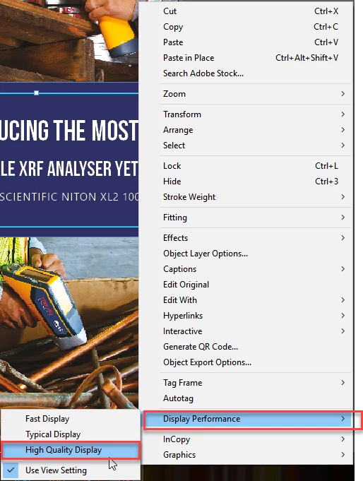

Also what preview mode in InDesign are you using?
Have you tried using High Quality Display settings?
Right click the image then >

Right Mouse click > Context menu > Display Quality
High quality may slow down the computer.
LoveGodAuthor
April 26, 2017
I have done that, it is on the highest quality possible, but it still looks pixelated.

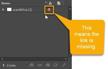

Have you checked the global display performance is on High Quality AS WELL AS the Image frame itself?
Is the file linked correctly?
Do you have any errors like this?
Or:
