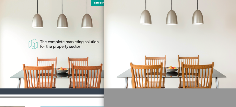

Help! I have noticed recently that when I make a print-ready PDF from InDesign files using settings that I have always used, some pictures come out unacceptably red, especially pictures involving wooden furniture or wooden surfaces. The PDF comes out of Acrobat looking different to the InDesign file (with a picture from a pro photographer). The same picture in a PDF from March 2022 looks fine, and I have not knowingly changed any PDF settings. This is a recent development and two clients have questioned it so far. I wonder if it is a problem, a change or a bug in recent Creative Suite versions that either hasn't been well enough publicised or not noticed. There may also be other changes such as pictures looking a bit dull or oversaturated other colours, but I haven't a clue what's happened or how to sort it out. The file attached is original PSD on the right and printed version on the left.

The main problems I have had are the wooden chairs on the cover turning very orangey (see also the PDF from March 22 for comparison), and according to my client, some pictures looking a bit flat. The chairs picture is the same file. The red is the main concern though. Having looked back at other recent jobs, there is evidence of the same problem, although not as severe. Any help gratefully appreciated.

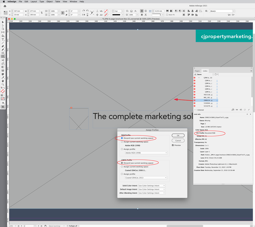

Hi @martina49216598 , The InDesign document has no color profile assignments, so the color in a PDF Export would be random.
If you check the chair image in the Links panel, it is listed as DocumentRGB (no embedded profile), and the document itself has no assigned RGB or CMYK profile. That means the color could change anytime the document is opened because with no profile assignements the document falls back to the current Color Settings’ Working spaces, which could be anything.
The Color Settings are your preferences for a new document’s profile assignments and color management policies. It looks like the RGB and CMYK Policies were set to Off when your document was created, or Color Settings was set to Emulate Adobe InDesign 2.0 CMS Off.

Also, if I inspect the earlier PDF, it was not saved as PDF/X-1a—the chair image is listed as DeviceRGB (no profile), which is not allowed in a PDF/X-1a. Because the image is DeviceRGB its color appearnce falls back to AcrobatPro’s Working RGB Space, which could again be anything. The chairs look different depending on my Acobat Color Settings when I open the PDF—it looks like you get the expected color appearance, but only if the RGB Working Space happens to be sRGB:

I find it unbelievably complicated and almost impossible to understand
A good start would be to load one of the default Color Settings presets before you make any new documents—if you really don’t understand how color profiles work I would start by sync’ing your apps to North America General Purpose.
Keep in mind Color Settings are your color preferences for new documents and generally don’t affect existing documents. It would be impossible to get the ID doc you attached with one of the default Color Settings. None of the RGB color is profiled and RGB color always needs an embedded profile in order to be accurately converted in to the final print space. The RGB color with no profile in your doc explains the inconsistent output.
