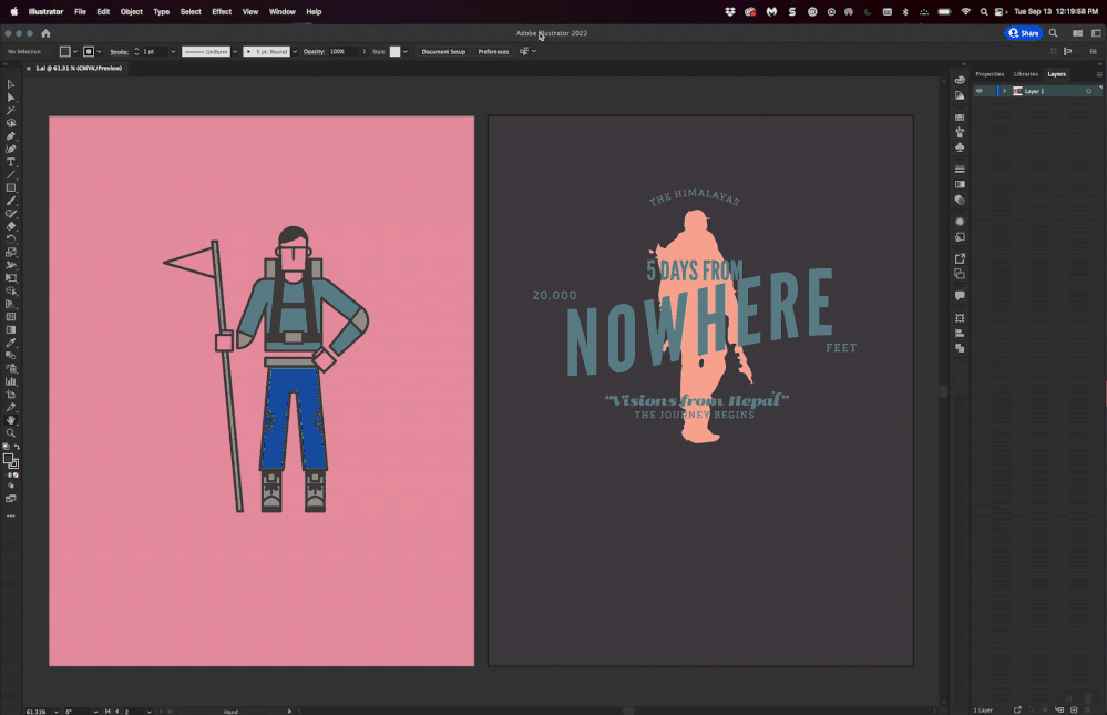

Banging my head on the keyboard over here. I've got a multipage PDF exported from an illustrator file with multiple artboards. Each artboard's dimensions match the InDesign document's page size, yet when I place the PDF it comes in at a tiny thubnail size and super pixelated as well despite Display Performance settings.
I'm thinking it's a glitch with the multiple artboards? Any suggestions are much appreciated.

Hi @gabrielamadeus:
Here's what I have so far, and it's not an answer—it just represents as far as I could go with it. It's something about how the .ai file was built because it happens in any .indd doc, not just yours.
When I unlock everything and select all on active artboard, the contents on artboard 41 (the top-most artboard) shows a height value of 2,275.4167 inches in the Transform panel. If I try to copy the contents to a new 8.5 x 5.5 page, the guide layer causes issues. If I hide the guides layer, I can copy the contents of artboard 41 to a new file, and the file places normally. Deleting the guide layer doesn't fix the issue, but it does allow you to move to the content to a new file.

I can't say I know why this is happening, but I think it's related to how it was saved in Illustrator. When I I saved as a PDF using the HQ Print Preset before changing to Acrobat 7 compatibility as you did I got a warning message that unless the file was saved in Acrobat 1.6 or later it would be scaled to 10%.
Doing that doesn't seem to affect InDesign, and I'd say that was a bug (or at least a failure to take that into considersation in the import coding).

Opened your Illustrator file with Adobe Illustrator 26.5.
See a lot of missing linked graphics with little "cloud" icons in the Links panel of Illustrator. Items that are placed and linked from a Creative Cloud Library. I have no access to that library so I cannot test anything. A warning message said that there are issues with previewing the document. Tried to get Overprint Preview. Did not work. Just the outline view of the artboard elements.
I also see that there are lots of PDF pages placed and linked. Links are all missing.
Also missing Illustrator symbols.
My guess now is that the placed PDFs are the core of the issue.
Could you please test what happens if you place and embed the PDF pages?
Best do that with only one single artboard in one separate document.
