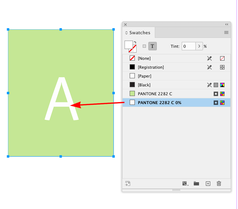

Hi @Janus Bahs Jacquet , I don’t think there is a perfect solution, but one option would be to define a 0% Tint Swatch of the Spot color when you are setting up the document, and always use that swatch for white:
Or, if you are like me you never make HSB swatches (which are really RGB colors with a different icon attached), in that case you could define the [Paper] swatch as HSB and allow Spot and HSB color spaces:

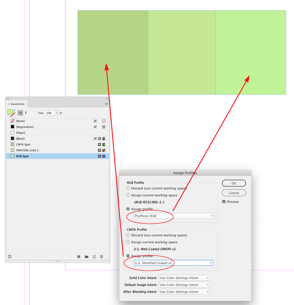

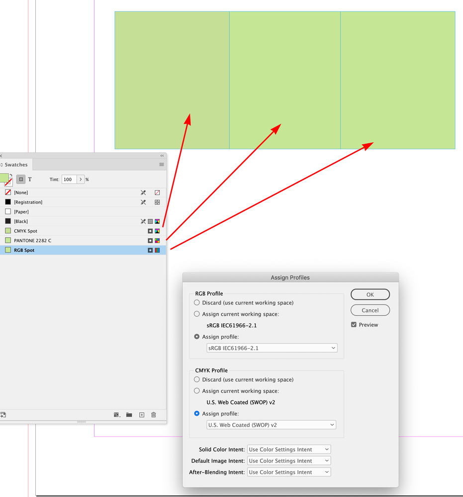

The spot’s color space wouldn’t affect the content of the plate at output, but it would affect how the color is displayed and proofed, which is the reason Pantone made the change.
There are 500+ Pantone colors, that are out-of-gamut to CMYK, and the document profile assignments change the appearance of CMYK and RGB defined swatches, but not Lab. Pantone 2282 is not in a print CMYK gamut, so I can’t find a CMYK match to the Lab value, and if I used the CMYK or RGB defined spots in a doc with different assignments, the display of the same color would change:

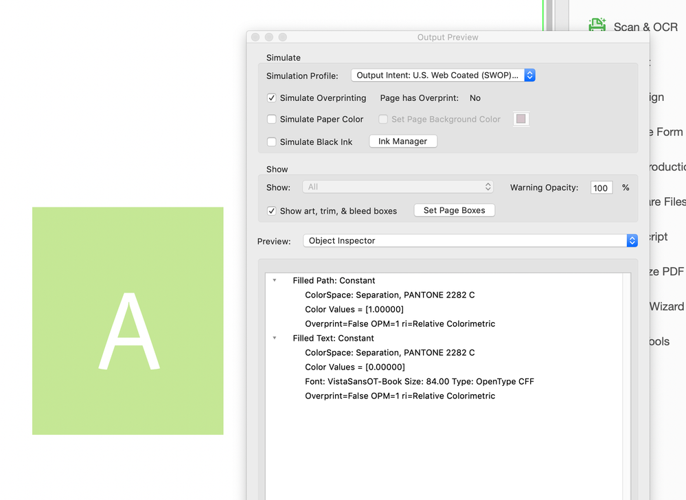

Hi @Test Screen Name , In the case of a spot color only document, I’m not sure there is a problem. A 0% Tint swatch of the spot color would inspect as the spot color, not CMYK in AcrobatPro. Here I’ve exported to PDF/X-1a, which forces all color to either CMYK or Spot and the white character inspects as 0% of the Separation plate:
PDF/X-4 with no color conversion outputs the same:
