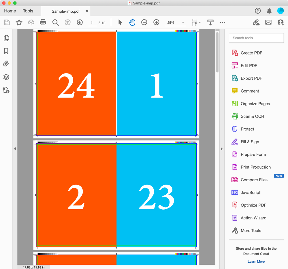

Hi @indiamachine36496519l9uo , If you are printing in house try this imposition script:
https://www.dropbox.com/scl/fo/2wjwe13fsrw9iszebo15e/h?rlkey=nwt5o3uex31fgra7oj15qvs7z&dl=0
The dialog:
Exported PDF
