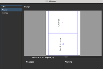

I am trying to create pdf as booklet, 2 page perfect bound, 2 up on letter size paper. I have spent the entire day reading this forum and trying figure out what has changed. Using indd, file>>print booklet; the preview to print is fine, but the pdf is not. I have tried a thousand different ways. There is no way to set page size or orientation. And if I follow other suggestions and I create a regular single page pdf and then try to print that as a booklet, saving as a pdf is not supported. Really frustrating.

From one of your screenshots - your printer can handle booklets...

  1.  File - Print Booklet
  2.  Click on Preview. For one side, page 1 (cover) and page 4 (back cover) will show. Odd number pages should always be on the right, and even number pages on the left side. This is what will show up when I print it up once I change a setting in the printer settings. Trust the setting
  3.  For my 'Home' Printer, I need to click on Print Settings. Setup. And change to paper size (Although my printer can print 13" x 19",) I elected to do my test print on letter size, 8.5" x 11". I am printing on landscape mode (second icon) for this test print I have to scale to fit to fit both pages in.
  4. Click on Printer. Normally, I have the setting off, but for this process I have it turned on...it may give you a warning. That's ok...click OK
  5.  Under Layout is a drop-down menu. Open that and select Two-Sided printing
  6.  After selecting tw-side printer settings, I change the binding from Short-edge Binding because I want to be able to fold the paper in half and have the right-side page facing up.
  7.  Hit Print. And vøila! Printed on one sheet of paper, with 4 pages on it! Sweet!
