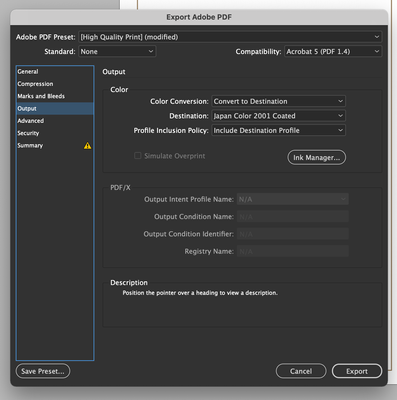

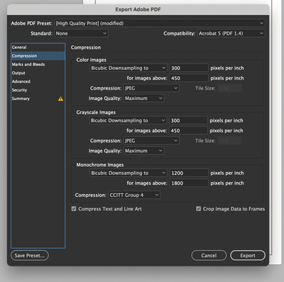

Here are my export settings

Hi @AndreeaCi , Is there a reason for converting your InDesign doc to the Japan Color 2001 Coated CMYK profile? That CMYK profile would be for an offset press, not a composite inkjet printer.
Inkjet printers almost always use RGB drivers—they expect the color to be RGB and the conversion to the printer output space is handled by the driver software’s media profile, which you choose in the Printer... dialog. If you want to export a PDF and print from Acrobat, try exporting to document RGB and see if that helps:
