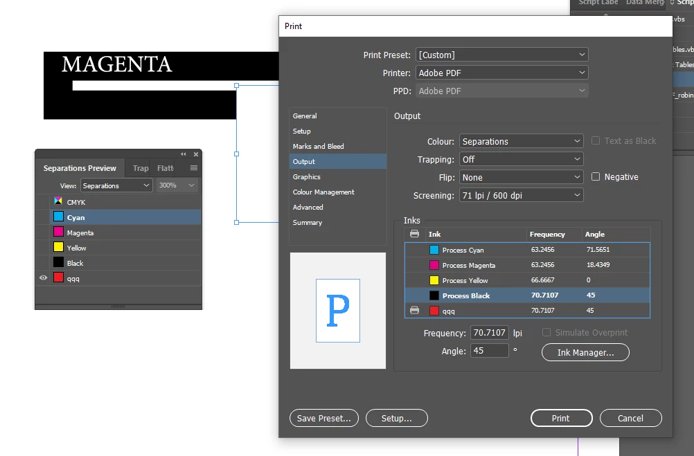

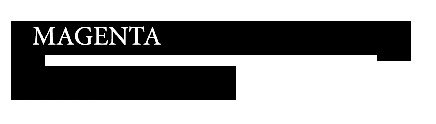

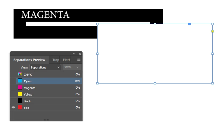

So if you have it as a SPOT color - then your preview should look like this - rectangle on the right is filled with Cyan, MAGENTA is a text converted to outlines - qqq is a rectangle with Gold stroke 😉
Then PRINT separations:
and the PDF will look like this:
Good old days 😄
Good old days 😄

This worked! Thank you for showing me that Print/PDF dialog. I didn't know that was where to turn off printing of certain separations.
