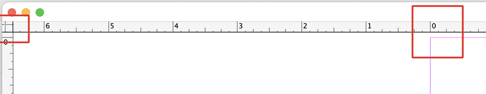

Additionally, make sure that the upper left corner of your document (highlighted on the right side of the picture below) is reading as zero on the top ruler. If it is not then double click on the dotted crossed lines which are highlighted on the left side of the picture.
