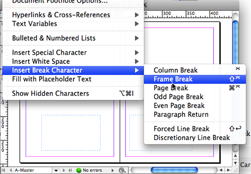

    vladan saveljic
    March 15, 2018
    you have probably inserted a break character
    did you click on Enter (numeric keypad) or Shift+Enter (numeric keypad)?
