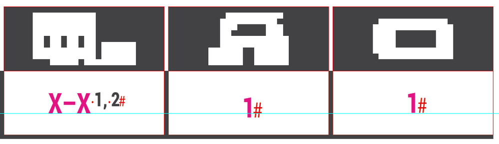

I've had this issue for ages now and still cannot find a solution that doesn't involve editing the Text Frame Options on every single text box on a page.
I am working with supplied artwork templates from a specific client in Germany. Whenever I select the text in a text box to edit it, the baseline shifts downwards, throwing off the templated text.
I have researched online and found, by trial and error, the only solution is to customise using Text Frame Options > Baseline Options, then select 'Use Custom Baseline Grid' and set Offset to 'Cap Height'. This re-sets the baseline again but I'm never confident it is exactly the same as the template I have been supplied as I am, essentially, tampering with a client's approved layout.
Is there a permanent solution to resolving this? I know this has been an issue going back quite a few versions of InDesign now and each update is supposed to have fixed this issue but it never has (and yes, I've used the old Preferences trash/re-set fob-off a number of times but this doesn't work, either).
Will this problem ever be resolved? It's not a good use of time to use the workaround every time I create a new file for this client as there are 20 - 30 text boxes on each artwork, which is a lot of extra unecessary editing that I can't bill onto the client.
I need to understand what is happening. Is it not retaining the custom preferences when I try to edit the text? I'm as at a loss as I was with this problem 2-3 years ago.

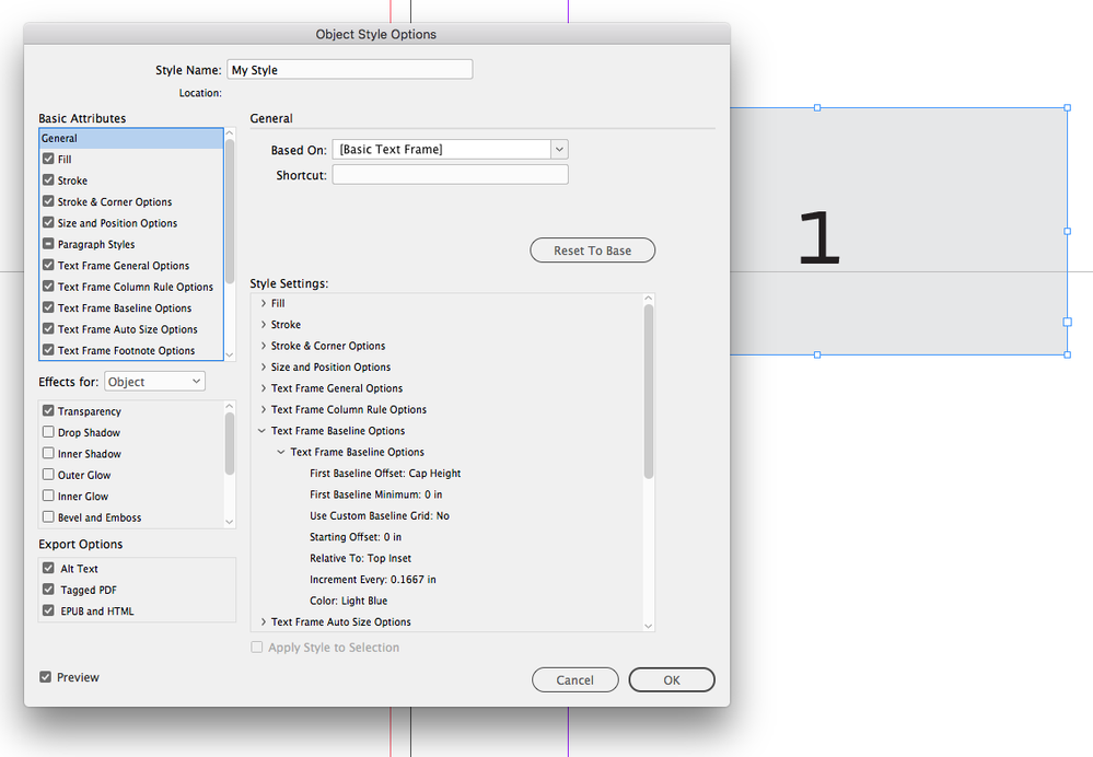

It’s the Offset that affects the starting baseline of the text frame, so with a text frame set to Center Vertical Justification, Cap Height would center upper and lower case text in the frame—you wouldn’t want to check Use Custom Baseline Grid if the object is to center the text.

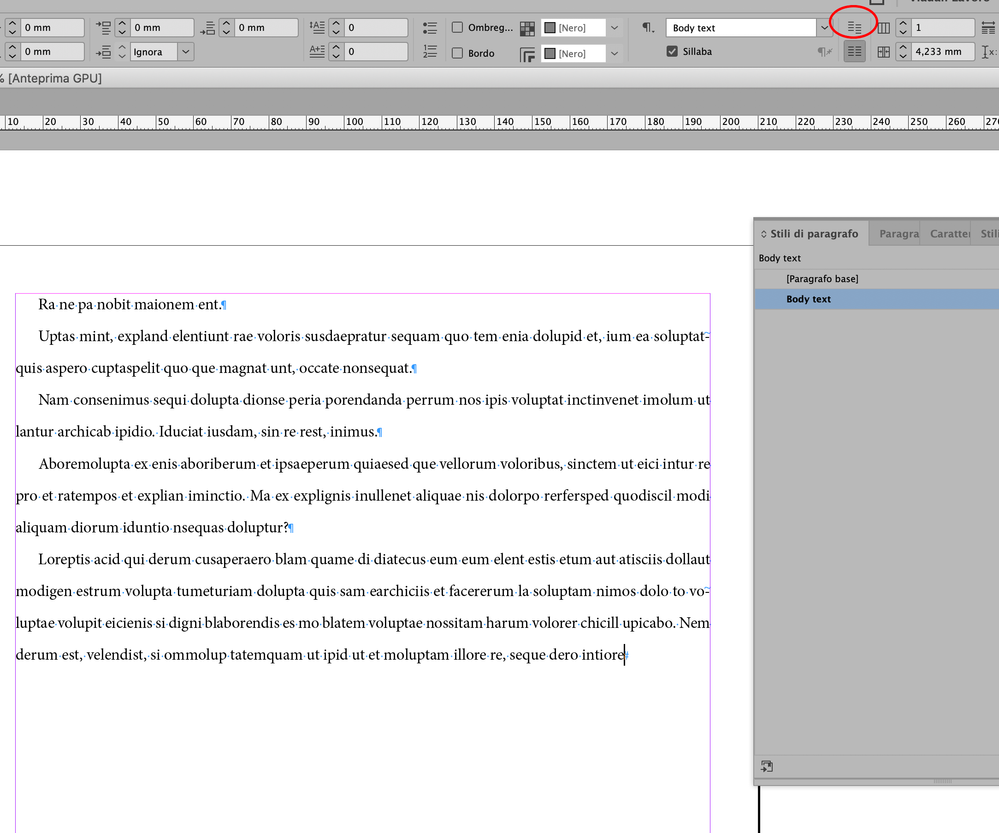

Did you check "Align paragraphs to the baseline grid"?
Select text. In the Paragraph panel or Control panel, click "Don't Align To Baseline Grid"

Hi Vladan
It's already set to "Do Not Align..."
If I switch between the two options to check the settings it resets the text box as per (2) in my screenshot above. With the exception of undoing (command Z) I cannot get it to reset to the original baseline setting - it just resets as per box 2 of my image.

This is what's happening with the file. If I open it and edit the text boxes for the first time, there is no issue with the baseline on the text boxes. If I rename the file, close it and reopen it to edit the text boxes again, that's when I'm finding an issue. See image below - box 1 (left) is the original template layout, box 2 (middle) is when I attempt to edit the text and the baseline shifts, box 3 (right) is when I've applied my workaround, but you can still see a tiny discrepancy on the baseline compared to the box 1.
Screen Shot 22.pngexpand imageScreen Shot 23.pngexpand imageScreen Shot 24.pngexpand image
You might want to check if the template is using Object Styles, which can include a First Baseline Offset setting. If the text frame has an Object Style assigned, which is Based on [Basic Text Frame] that might cause a conflict.
Screen Shot 27.pngexpand image
