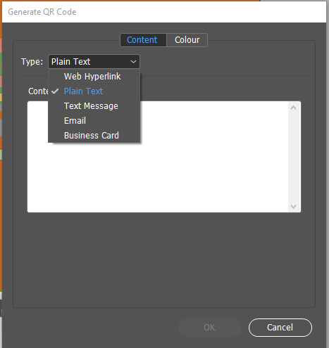

Correct answer Colin Flashman
Use the plain text option as Srishti has said, but enter in the following syntax:
BEGIN:VEVENT
SUMMARY:Test Meeting
DTSTART:20080811T190000Z
DTEND:20080811T200000Z
END:VEVENT
The start date is DTSTART and is based on UTC time, as is the DTEND (end date).
The full (and very boring) specs about all syntax can be found here: http://www.ietf.org/rfc/rfc2445.txt
And there is another great source of QR code syntax here: Barcode Contents · zxing/zxing Wiki · GitHub
If you're trying to do a data merge QR Code, the syntax will need semicolons where there are line breaks in the above syntax. There's more information on QR Codes during a data merge here: https://indesignsecrets.com/data-merge-qr-codes-explained.php

Srishti Bali
February 6, 2018
Hi PAWU,
You may find this option under Object menu, go to Object > Generate QR Code.
Here are the options available:
Srishti
