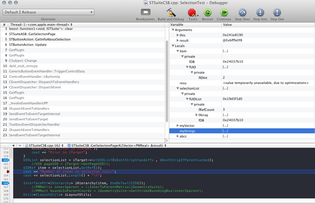

Hi I found out that, I have in item list fRefCount 3 see following picture:
I would like to know, what that mean? does it mean, that i have 3 items on page?
