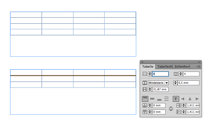

At least on the height I can proof a height under 1.058 mm by scripting.
1. Set topInset and bottomInset of all cells in a row to value 0
2. Set the pointSize of texts[0] of every cell in a row to value 0.1 or less
3. Apply the height. E.g. "0.5 mm"
See this screenshot from InDesign CC v9.3.0 (also tested with CC 2014.2) where I selected and changed the height of the cells of the second row in the table to 0.5 mm:
However, doing the width of a column with less than 1.059 mm is not possible by scripting the DOM with CS6 and above. Editing IDML or editing IDMS and placing the table will result in widths less than 1.059 mm.
