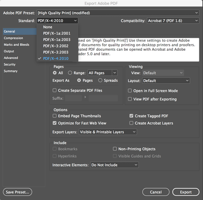

I was finally able to save it using the "standard" dropdown box, which I normally don't use. For some reason that worked for me!

I have trouble exporting to PDF with the 15.1.1 version. It won't let me export to anything but PDF X-4.
