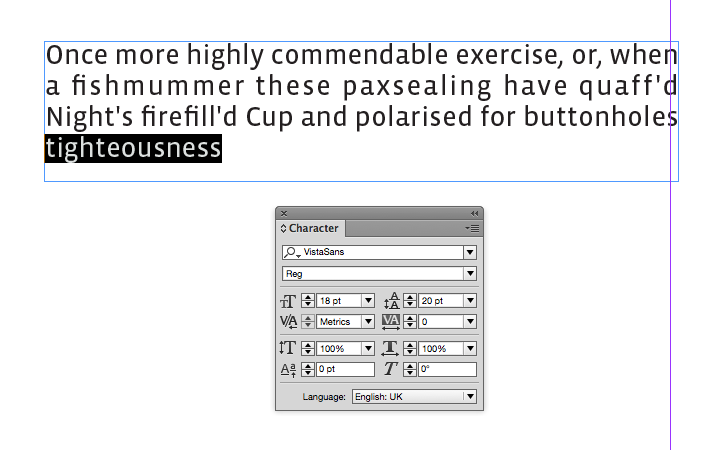

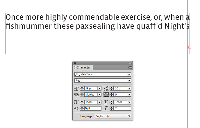

Could you have No Break applied to other words in the text? Something like this where I have applied No breaks to the words in front, which forces the entire line to break when I add the last word:
If I clear all the No Breaks in the text and then apply the No Break only to the last word, it works as expected
