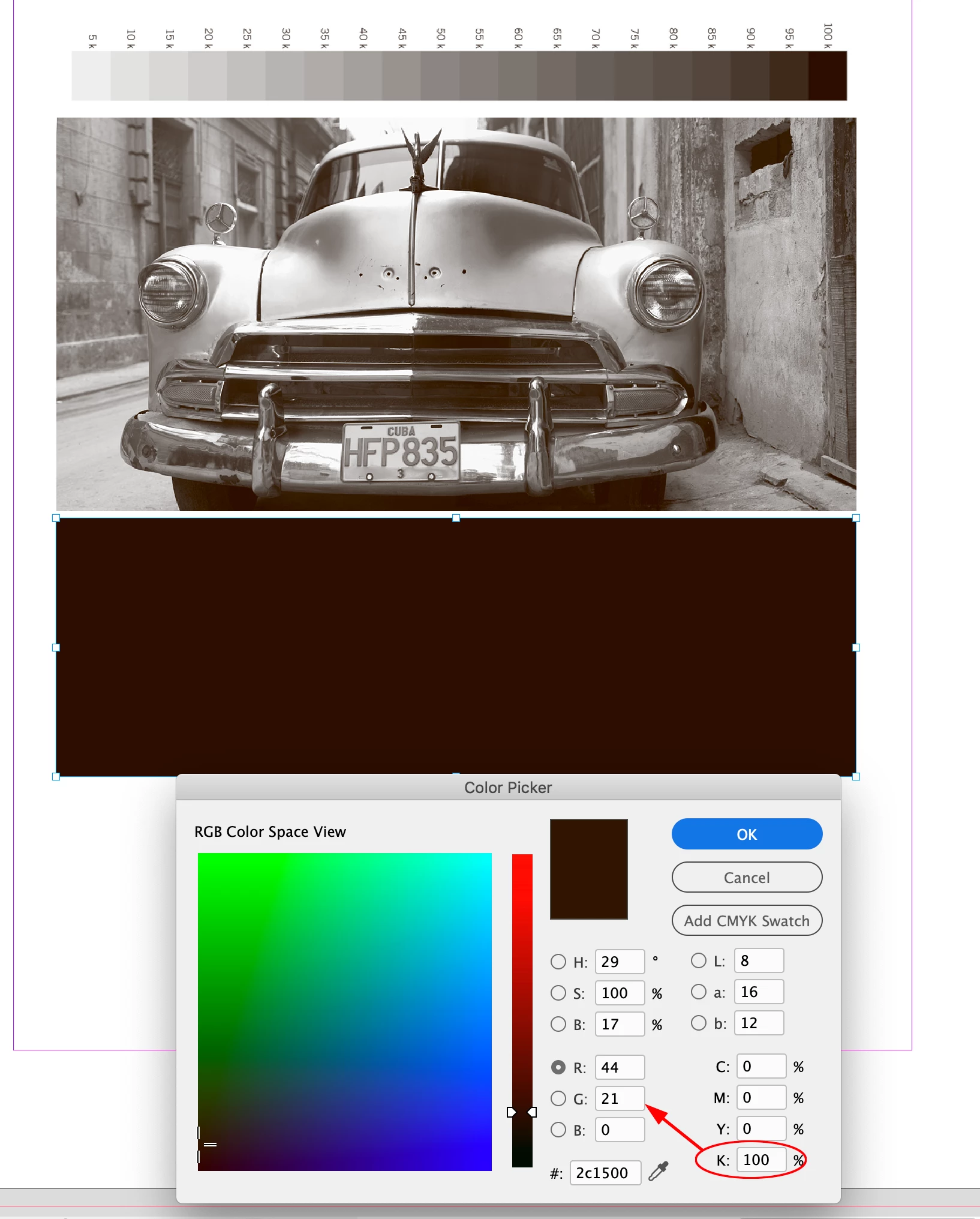

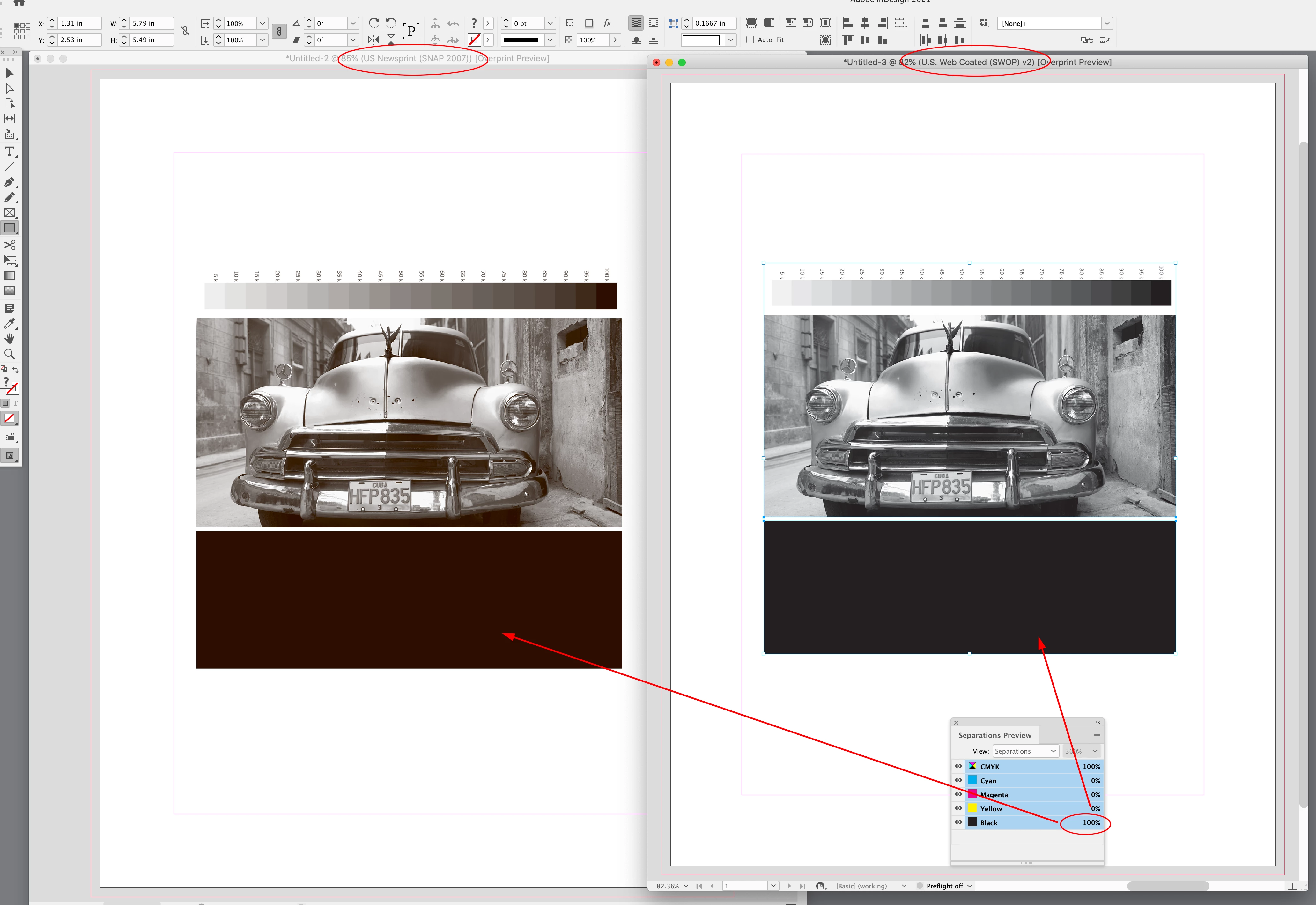

Hi @sd5e8a , When you place a grayscale image in InDesign its embedded Gray profile is ignored and, with Overprint Preview On, it is previewed via the InDesign document’s CMYK profile showing how it will print on the CMYK Black plate. Same happens in Acrobat on a PDF/X Export to Document CMYK.
A defect of Gray ICC profiles is, the Black ink color is assumed to be absolute black with no color cast, while CMYK ICC profiles capture the black ink’s density and color characteristics. You can see that if you turn on Overprint Preview and compare the difference between a newsprint profile and a coated profile—100% black would be far from absolute on newsprint.
These pages have identical outptut values, but different CMYK profile assignments. Default US Web Coated SWOP on the right, and US Newsprint on the left:
You can see the affect of the Newsprint profile on 0|0|0|100–it converts back to RGB as 44|21|0— not 0|0|0
