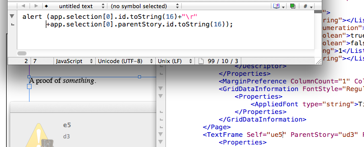

Sure there is a relation, it's even very easy to set up a test for this.
Of course, Adobe could have chosen to 'make up' the Self IDs as they are written out into text form in the IDML -- but then they'd have to keep tabs on what number is used for what object. But why should they? The internal ID already is a unique identifier for every single object. For a document, it's the same inside the UI, in its binary INDD file (if you know where to look), and also in an IDML exported from same.
Top left: a short script. Center left: a random InDesign document, with some text frame selected. Bottom left: the output of aforementioned script. Right, in the back: the Spread.XML file in an exported IDML of this very same document (the spread file is named "Spread_udb.xml", and I'm convinced another test script would show me that's the actual ID number of this spread). As you can see, the <TextFrame> "Self" ID is "ue5" and its "ParentStory" is "ud3". I'm guessing the 'u' here is an abbreviation for 'unsigned int'; the next characters are the ID numbers in hexadecimal.
But why would it matter to you? Any operation you perform may reshuffle the IDs around, and if you are somehow counting on the ID in a previously saved IDML file staying the same in your "live" document, you might get the occasional surprise. The same goes for saving an object's ID inside a script and relying on that staying the same, all through your ID session. It's way more safe to assign a label to the objects you are going to manipulate.
