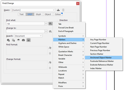

Aug 10, 2021 Aug 10, 2021
Look for ~a (in the Grep tab of the Find/Change window).
You can find it in the flyout menus of the Find/Change window
