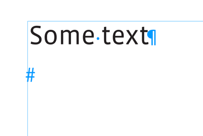

Hi @Karthik SG , just to clarify are you trying to remove the paeragraph return or the end of story invisible (#)?
Removing the return I would expect this:
app.findGrepPreferences.findWhat=NothingEnum.NOTHING
app.changeGrepPreferences.changeTo=NothingEnum.NOTHING
app.findGrepPreferences.findWhat = "\\r";
app.changeGrepPreferences.changeTo = "";
app.activeDocument.changeGrep()
