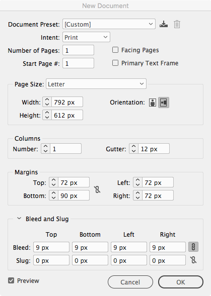

The exported pixel dimensions would depend on your page dimensions. If your document setup is the default print Letter (11"x8.5"), InDesign defines it in pixels as 792x612 px. So, if the jpeg export is to 72ppi the resulting pixel dimensions will also be 792x612. If you export to 300ppi the pixel dimensions will be 3300x2550 (11x300=3300, 8.5x300=2550)

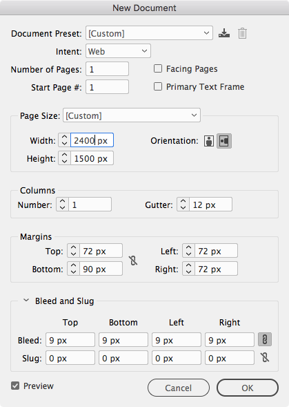

You can also setup a document to a specific pixel dimension, and in that case the export at 72ppi will maintain the document's pixel dimensions (web browsers or HTML pages have no PPI property). I might decide the highest screen resolution of my target audience is 2400px wide and set the page accordingly:
