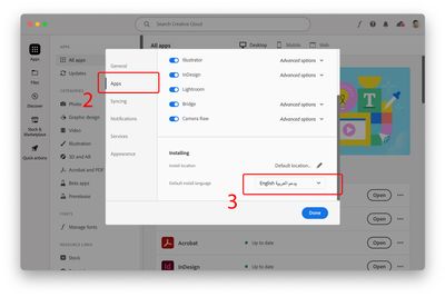

Willi Adelberger
Apr 27, 2022 10:32 AM UTC
If this disappeared, you have probably installed English with Hebrew support.
Change in the CC App to English with Arabic Support,  install ID and IC again. After installing change back to your standard language and you have all needed tools.

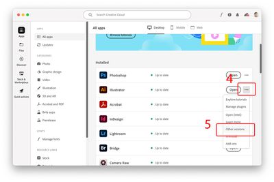

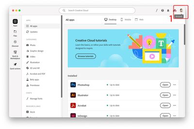

Apr 27, 2022 10:17 AM UTC
Marhaba Gaby. The Paragraph Direction buttons were never removed from InDesign, they're still there.
Make sure you have the correct language settings in your Adobe CC desktop application so that next time you update any Adobe software, the right update for your language preference will be downloaded.
Apr 27, 2022 4:26 PM UTC
Shokran Zaid!
All my settings matched yours: the language settings (I've had it set that way for 2.5 years now) and the version, but, the toggle simply was not there on 17.2 for me and was there in 17.1.
However, this morning there was a new update, and I am now in 17.2.1 and the toggle is back.
I have no explanation whatsoever, as literally the only thing that changed was updating from 17.1 to 17.2, reverting back to 17.1 then this morning updating first to 17.2 and then 17.2.1 as soon as I got the notification that there was an update.
Either way, it's back, yay! Thank you so much for taking the time of puttin together all the screenshots.
