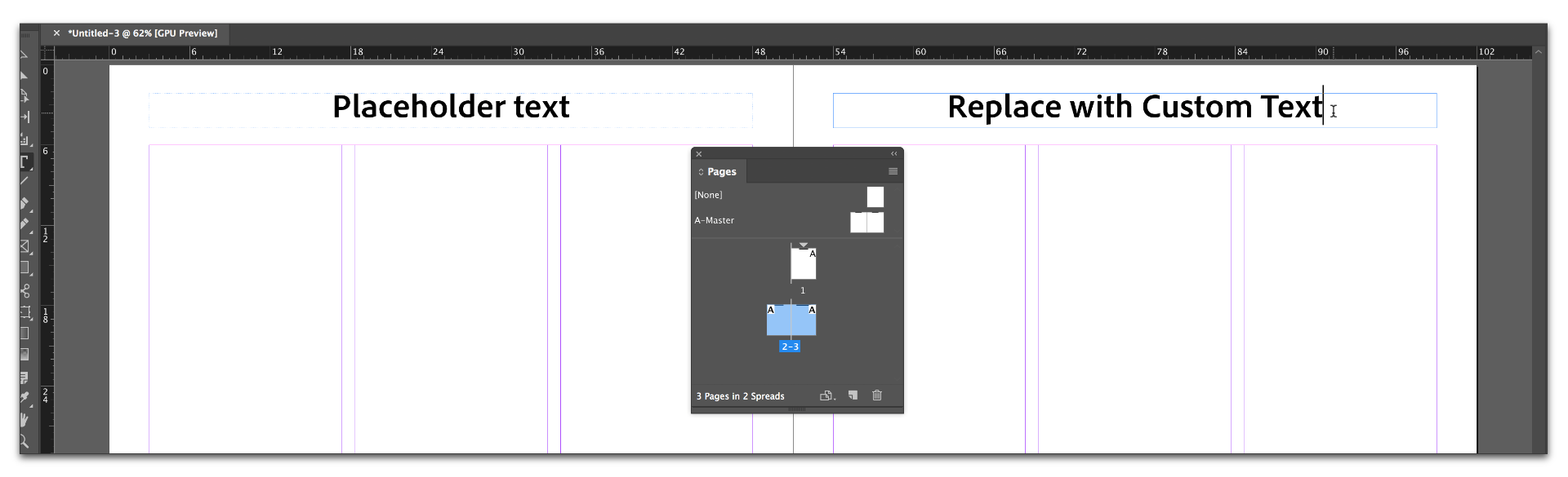

The text frames are on the A-Master. Note the dotted blue outline on the unselected frame, and that you can select the frames. Add the text, format.
Navigate to the body pages. The text frames are visible but not accessible on the body pages. You cannot select the frames. Note the dotted blue outline.
Still on the body pages, Control Shift click (Cmd Shift click on a Mac) on the text with the Selection tool. Note that the dotted outline is now solid, and the frame is selected.
Still on the body pages, switch to the Type tool and replace the text.
