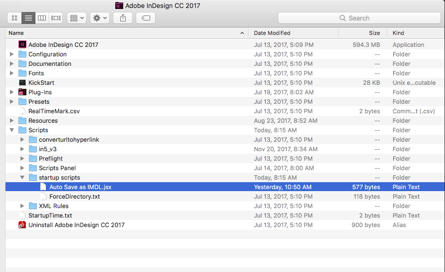

Mentor ,
Dec 12, 2017 Dec 12, 2017
hmm.. it does not work, i have it in the panel, i restarted indesign. I am on cc indesign 2017, does that makes  a difference?
Valorous Hero ,
Of course, it won't work: you put it in a wrong location! Read my posts again — carefully.

Mentor ,
Dec 13, 2017 Dec 13, 2017
Ok, yes, i placed it in that folder. see below. i quit indesign, re-opened, tried to make a .pdf, but the imdl file was not created.

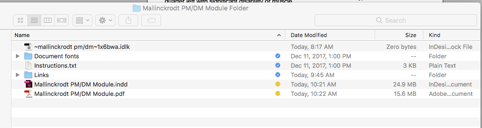

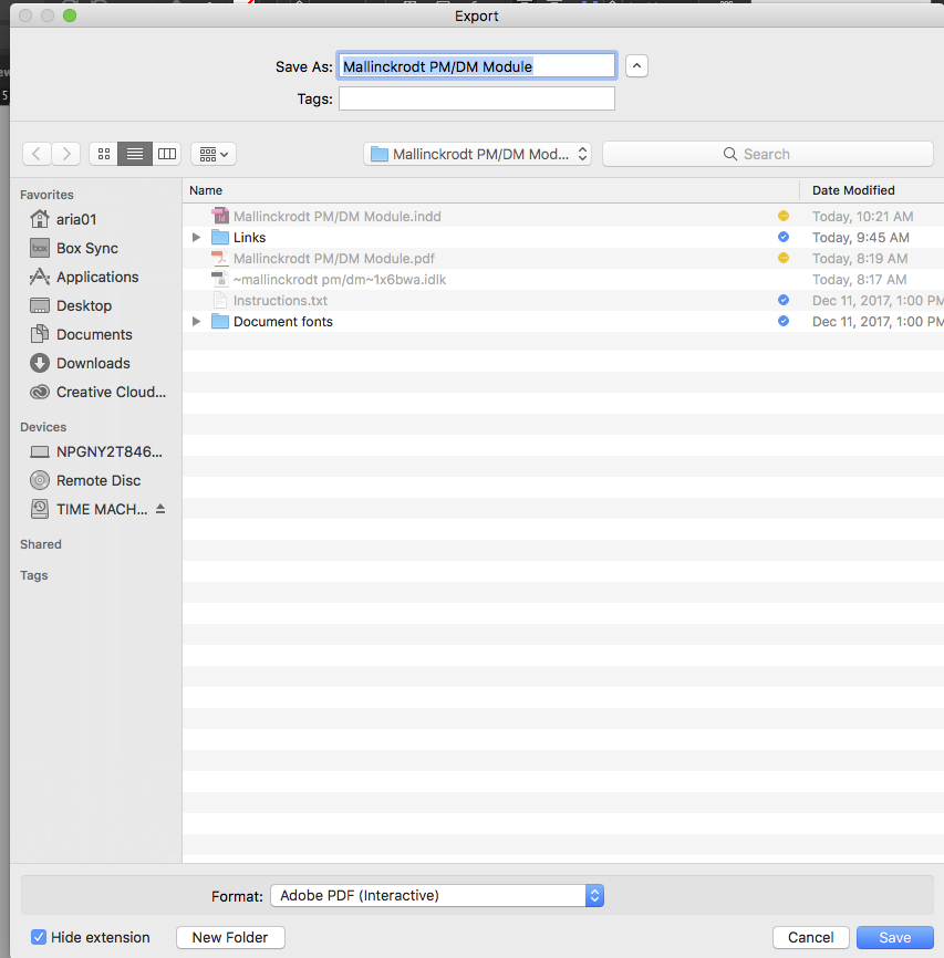

Mentor ,
i go to file, export, interactive .pdf, see below:
it makes the .pdf but the imdl is not there.. see below:

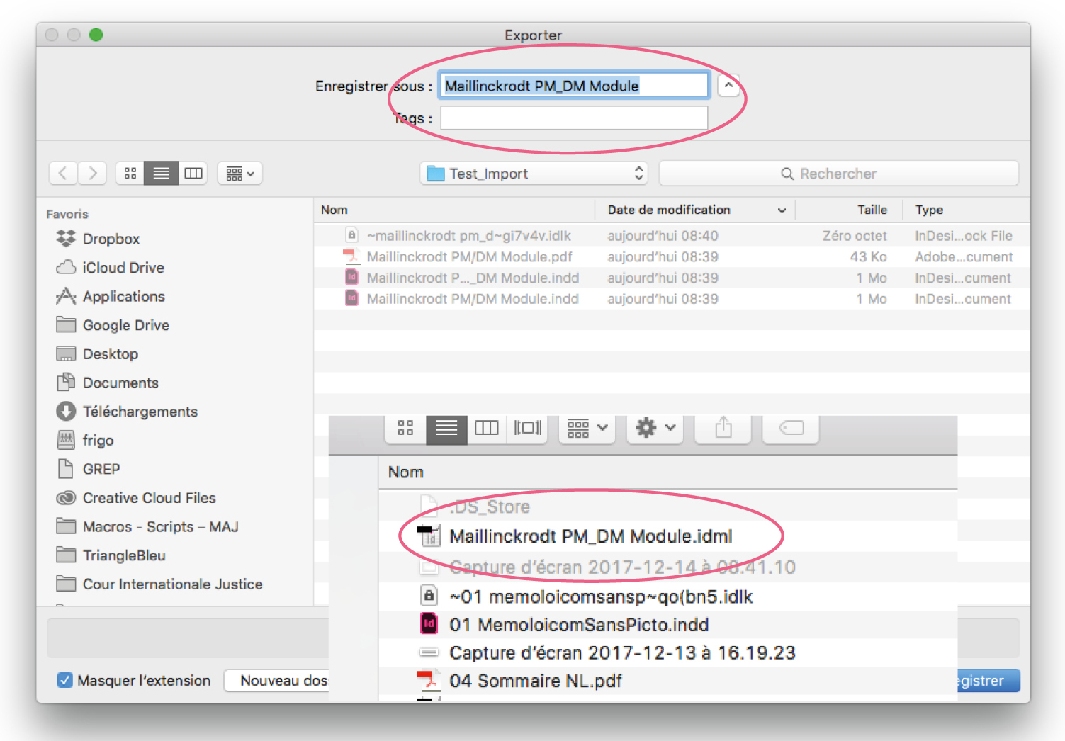

Enthusiast ,
Dec 14, 2017 Dec 14, 2017
Hello everyone/Bonjour à tous
Kasyan Servetsky​,
I just retest your code on MAC with Indesign CC2017.1, it functions very well, the only thing I had to do, is the names of the menus, as explained above.
Je viens de retester votre code sur MAC avec Indesign CC2017.1, il fonction très bien, les seul chagement que j'ai du faire, se son les nom des menu, comme expliqué plus haut.
Here is the code (your Kasyan code):
Voici le code (votre code Kasyan):
#targetengine "Kasyan"
    var eventListener = app.addEventListener("beforeExport", exportIDML, false);
    function exportIDML(event) {
        try {
            if (event.format == "Adobe PDF (impression)" || event.format == "Adobe PDF (interactif)") {
                var doc = event.parent;
                var idmlFile = new File("~/Desktop/" + doc.name.replace(/indd$/, "idml"));
                doc.asynchronousExportFile(ExportFormat.INDESIGN_MARKUP, idmlFile, false);
        catch(err) {
            $.writeln(err.message + ", line: " + err.line);
And my conclusion, the base script works but the file name can not contain "/" because it looks for an additional directory, in the end the "filePath" is "~Desktop/Maillinckrodt PM/DM Module.indd", it looks for a folder that calls "Maillinckrodt PM" and that does not exist so it does not create a file.
Et ma conclusion le script base fonctionne mais le nom du fichier ne peut contenir de "/", car il recherche un répertoire supplémentaire, au final le "filePath" est "~Desktop/Maillinckrodt PM/DM Module.indd", il cherche un dossier qui d’appel  "Maillinckrodt PM" et qui n'existe pas donc il ne créé pas de fichier.
With replacing "/" with "_", it's OK.
Avec le remplacement du "/" par "_", c'est OK.
Enthusiast ,
Good evening,
The script saves on the desktop even though it happens
Bonsoir,
Le script sauve sur le bureau quoiqu'il arrive
But it seems to me that the name of the file "Maillinckrodt PM/DM Module.indd" is problem, test without putting "/". and check on the MAC desktop ("~/Desktop/").
Mais il me semble que le nom du fichier "Maillinckrodt PM/DM Module.indd" est problème, tester sans mettre de "/". et vérifier sur le bureau du MAC.
