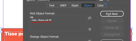

I just realized there are some frames in "Akane red" color that Find/Change is not picking up. I found out that the swatch name is changing somehow by adding some random numbers at the end (see screenshot). This is the first time that I'm seeing it. Any thoughts? I guess that's why the script is not working on these particular frames.
Anyway, I found a workaround by finding Inset Spacing instead - the text frames are set to 8,8,10,10 or 5,5,5,5 (Top, Bottom, Left, Right). I'm attaching some files for your reference here. See script below - Sorry, it dosn't look as great as yours and there might be some unnecessary lines hahah. So, I'm try to figure out how to make it work on multiple documents. For now, it works only on a single document and the rest remains the same. Could you please take a look?
