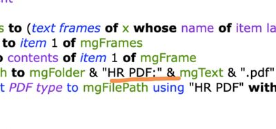

Hi all, apologies for tagging along with this post but i'm also having a similar problem since updating to Indesign 2025 (v20). We run a script which outputs indiviual pdf pages from a multi page document, named using a specific filename on a seperate layer into a HR Folder in the same folder location as the active indesign doc. This has worked for years prior, and still does with Indesign 2024 so just wondering what the fix could be here? Currently holding back on full update to 2025 but with a lot of other colleagues starting to update it's becomming a bit of a problem.
I run the script and it still runs as it should without any error messages however, in the HR PDF folder that it creates it is always empty with no PDF exported? Any help would be massively appreciated. Script we're using is attached below for ref - thank you!

Thanks @Robert at ID-Tasker , explains it clearly for a novice like myself to understand! So knowing that, is there a way to adjust/tweak the current script for it to work in POSIX path Style at all?

POSIX path of yourHFSPath

I think this:
":" - you should change it to "/" or "\" - I'm not a Mac user.
Community Beginner ,
Mar 05, 2025 Mar 05, 2025
No good unfortunately @Robert at ID-Tasker , tried both with the same result being an Error Number: 258

As per error - there is no folder - probably, because it's still HFS path?

The below is what i changed in the script as you suggested. Apologies for my low key understanding of this, it's a script i've picked up from an ex employee so not something i usually delve into. Have i misunderstood what you suggested @Robert at ID-Tasker ?
