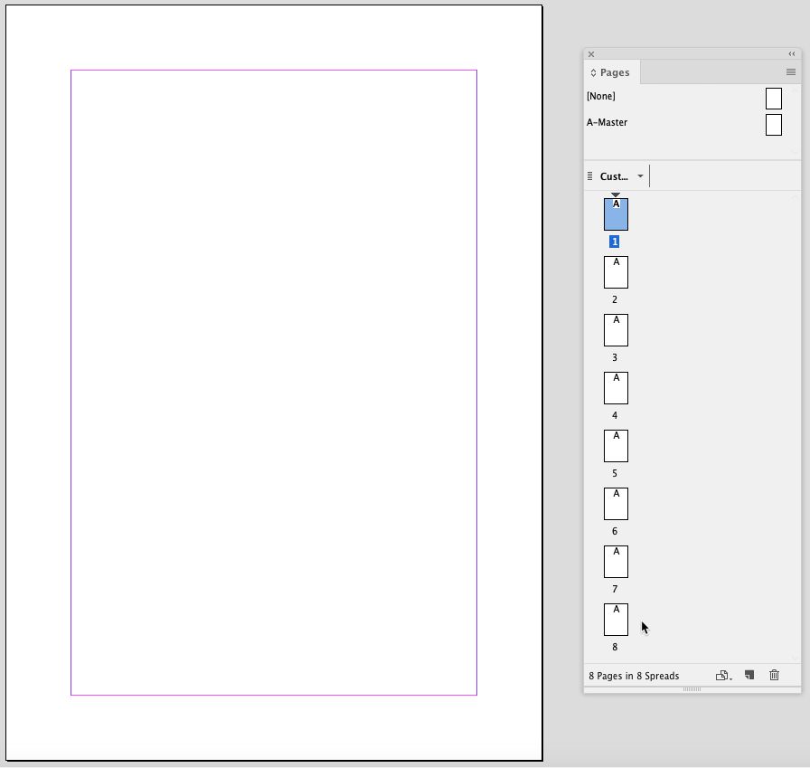

I think perhaps the first thing driving you crazy is that you're thinking of cutting your A5 pages in half to create spreads and then somehow building them in pieces, instead of letting InDesign do it for you and make the job easy on yourself. Set up an 8-page half-an-A5 page-sized document, 105mm wide by 148mm tall, with no facing pages, like the example illustrated below in the new document panel.
InDesign lets you stick pages together to create multi-page panels, so you can design brochure panels the way you'd see them in your finished brochure. By default, we're going to create a document with 8 individual pages, stacked 1-up in the Pages panel, as shown in the illustration below:

Go to the flyaway menu on your Pages panel and turn off both the Allow Document Pages to Shuffle and Allow Selected Spread to Shuffle options as shown at lower left by selecting first one, then the other, in the menu. You'll know you've done that when the check marks to the left of those commands disappear. Then, take your cursor and place the page 4 icon on top of the page 3 to create your (first) gatefold panel of two pages and place your pages 6 through 8 on the icon for page 5 to create the four-page (second) gatefold panel, as shown below right.
Your pages panel — and your gatefold page spreads — should look like the example below:
Design your inside panels one by one. Don't worry about the inside page dividing lines on the gatefold panels. If you want, you can design right over them as you tell your story the way you want to tell it. This will be a lot easier than trying to fill little spaces inside a great big sheet with the story you want to tell.
