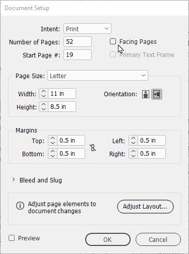

It's a little unclear what you are asking for here but if the goal is to break your spreads down to single pages for the pdf then simply choose "Pages" in the General section of the Export Adobe PDf dialog window which appears when you export a pdf using File>Export>Adobe PDF (Print).
If your goal is to make the InDesign file into single pages then go through File>Document Setup and uncheck Facing Pages. If "Allow Document Pages to Shuffle" is checked in the Pages Panel pull-down menu then the spreads will all automatically change to single pages. If that option is unchecked then the spreads will remain in their original configuration (although it now will have the apperance in the Pages Panel of a single page document) but you will now be able to manually separate them into single pages.

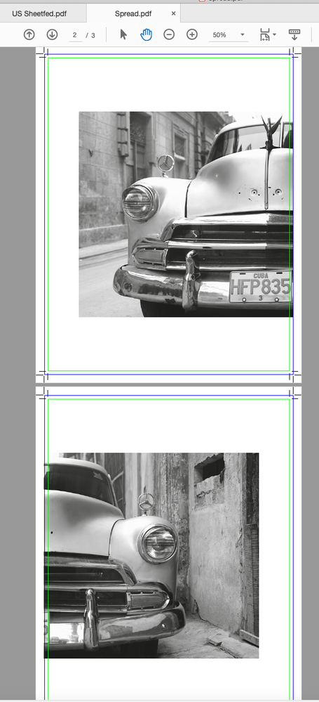

For the printer the export setup would be:
The exported single pages in Acobat:
For the client Export with Spreads checked:

Export>PDF>Marks and Bleeds set the Bleed amounts to 0.
Copy link to clipboard
Copied
You, sir, are a genius!!!!
