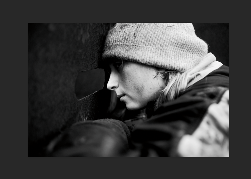

Below is the soft proofed image with soft proofing viewable in photoshop:
Below is the soft proofed image in photoshop with the soft proof turned off. a little darker and less contouring in the shadows.

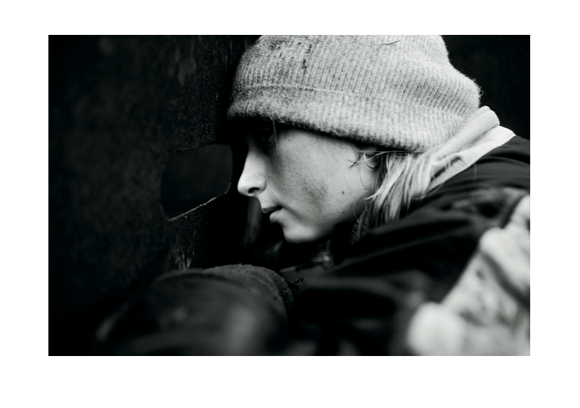

below here is the image from the exported PDF from InDesign. Which is nowhere near the second image that has been soft proofed. Way more black and no detail in the shadows anymore.

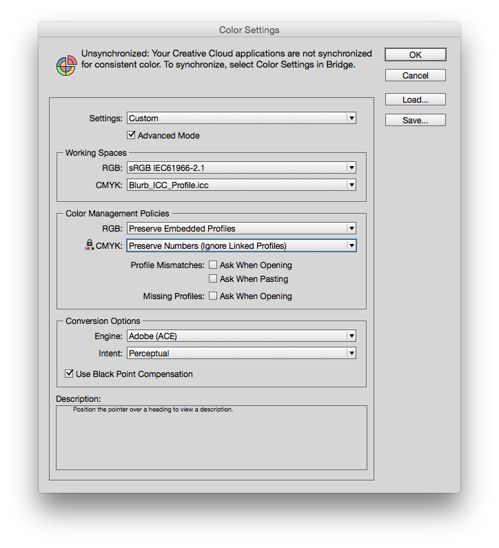

Before you make your document in InDesign, setup your Color Settings like this. Note that Blurb recommends Perceptual, but I prefer Relative because there will be little or no tonal change with neutral RGB images when you convert to CMYK. If you are working with an existing document make sure the Blurb profile is assigned to the document check Edit>Assign Profiles... It's the assigned profile that color manages the doc, not Color Settings' Working Spaces:

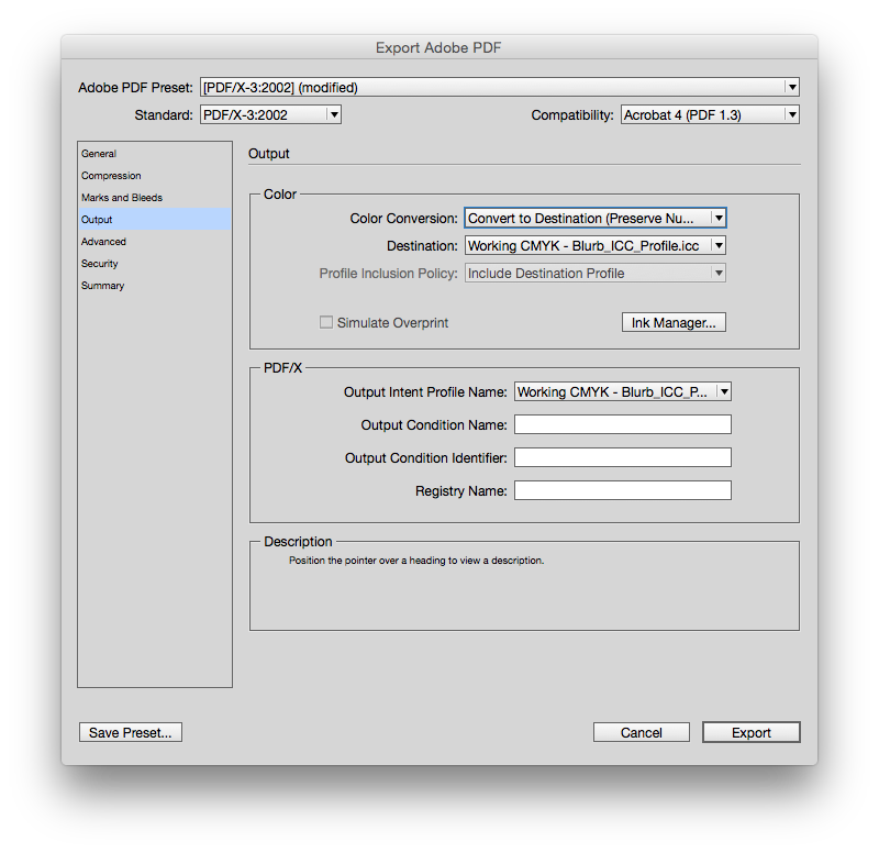

Blurb asks you to use the PDF/X-3 preset, which flattens transparency and keeps color unchanged. If you want to follow their instructions explicitly do this (this is effectively the same as PDF/X-1a)
