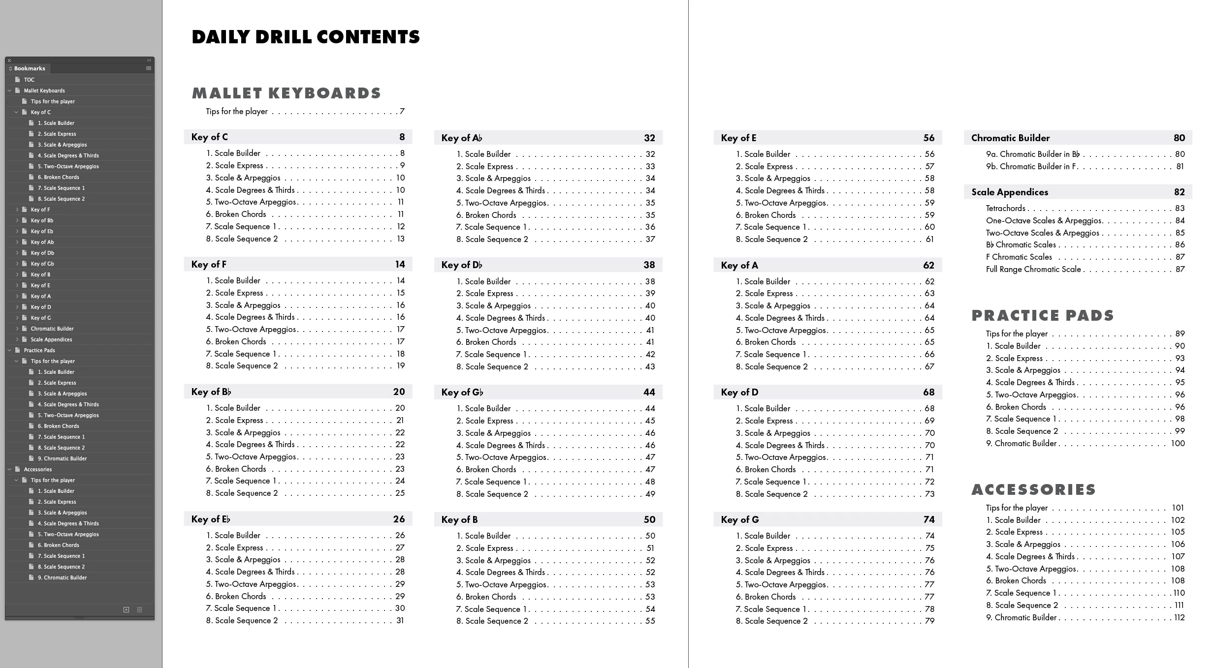

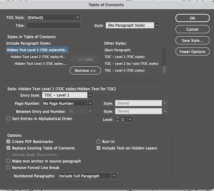

I've attached screenshots of the TOC dialog with the various levels selected as well as a picture of the TOC spread with the bookmarks panel showing.
The Level 1 entries "PRACTICE PADS" and "ACCESSORIES" are the headings under which these outlier cases are occurring. They are displaying exactly how I want them to display in the TOC, yet the bookmarks are confused into showing Level 3 entries all nested into the very first one ("Tips for the player").

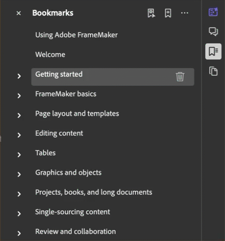

Well, let's think about how this would work in directly in Acrobat without InDesign's involvement... you can drag a bookmark up or down in the Bookmarks pane, as well as left and right to nest/unnest. But there is no way to drag a level 2 bookmark to a level 3 position unless there is a level 2 bookmark above it.
In my demo below, Getting started is level 1, and What is FrameMaker is a level 2. I can drag What is FrameMaker to a level 1 or back to a level 2, but there is no way to drag it to a level 3.
InDesign is just automating this manual process. I realize this is disappointing for you, but I'm actually impressed with InDesign's ability to adapt to the unusual/unsupported request and not just crash.
I would create a new paragraph style for the items under "PRACTICE PADS" and "ACCESSORIES" and designate those as Level: 2. This will fix the bookmarks pane, and you can map them to Entry Style: TOC - Level 3 and not mess up the actual TOC.
