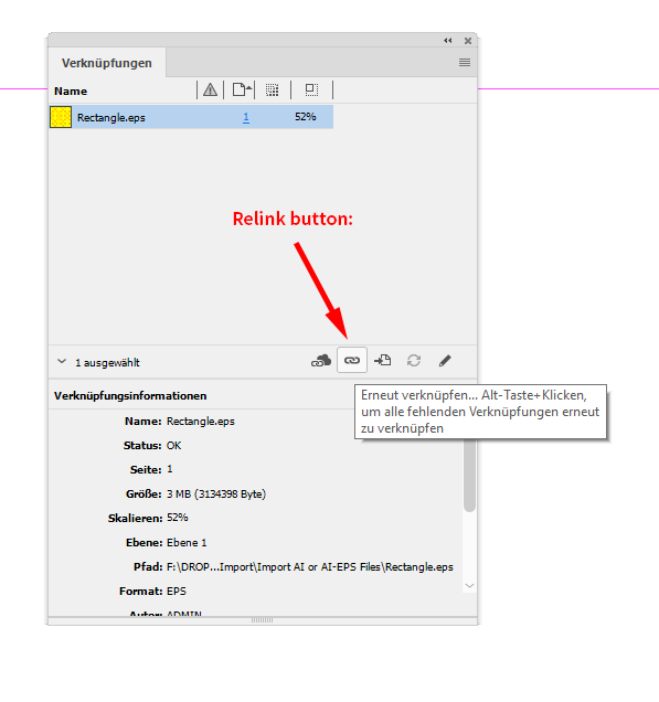

Hi jrm21 ,
what happens if you are using the functions of the Links panel to update the placed EPS graphics?
Select the frame holding the old EPS file, go to the Links panel and do Relink with the new EPS file.
Uwe
Explorer ,
Feb 13, 2019 Feb 13, 2019
"Relink" is not an option for an empty image box.
"Relink" on a box with a different image works as expected, but so does drag/drop and Place. The problem is only with an empty image box.
