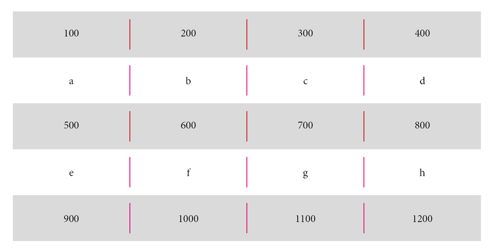

Hi learizam,
what you try to do is possible with a seldom used feature in table cells.
It creates a stroke with an actual stroke width but with the stroke color [None].
Example below.
All the horizontal strokes have a stroke weight, but no visible fill color.
The first row is filled "traditionally", the third row is filled "special":

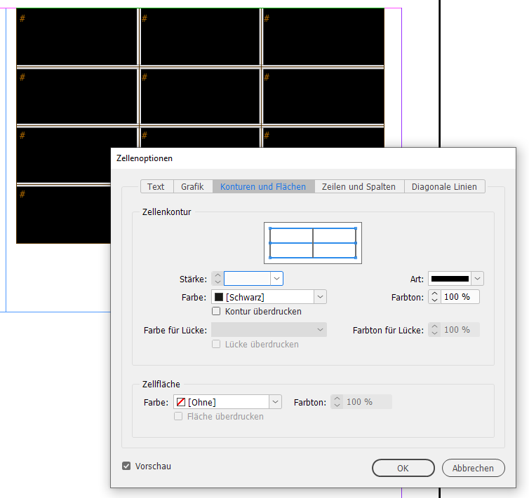

[1] Select all cells in the table ( select one cell and then do Select All )
[2] Open dialog Cell Options > Strokes and Fills through the Table main menu
[3] In the widget for cell strokes, select horizontal strokes only. Click on the vertical strokes to make them gray, that is the indication for not selected:
[4] Now comes the most important part. For Type scroll down to the bottom of the list and choose "None". Make sure that Preview is on. You already will see the horizontal gaps between the rows if your stroke weight is large:
[5] Now for the fill of all all cells in a row. The "traditional" method will not work: Select all cells in a row and apply a fill color from the Swatches panel:
Instead, and here comes trick #2, use a diagonal stroke as a fill with a huge amount of line weight. In my case below I did a 100 Pt stroke diagonal line. You'll find this feature in the last tab of the Cell Options dialog:
