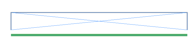

You could use the scissors tool to cut the image frame at the lower two corners. You do end up with multiple objects, but you can group them readily enough.
Save the group as a snippet for easy import into documents.
