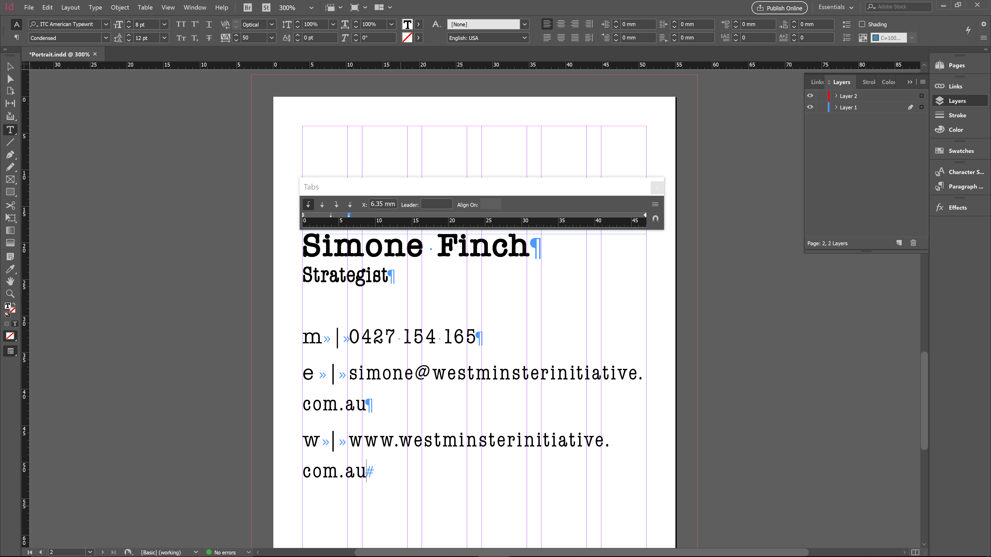

I'm just having a little bit of trouble trying to get my tab spacing to line up for me, and was hoping to get a little help.
I have attached a screen shot to help explain. Basically I'm trying to get the verticel bar on all three lines to line up. I have opened the tab display and adjusted all three lines to where I want the tab to start and end. This seems to have worked here the "e" and the "w" are concerned, however as you can see the verticle bar after the "m" is further indented. I realise I've no doubt done something very stupid, or just forgotten to do something, but it's been driving me crazy.
I have tried adjusting each indivual line and trying to aling them visually, but I can't get them to line up right that way either.
Any help would be appreciated.
Cheers.
Your first screen shot shows the settings for your second (correct) tab. Neither shows what you have for your first tab. Since you are not you styles, select all three lines (or use shift+return at the end of the first two to make them one paragraph).
I suggest a decimal tab for the tab type, with the pipe character instead of the default period for the Align On, as shown below:
(If this does not work, please select your paragraphs PLUS the tab stop and post another screen shot.)

I have tried adjusting them individually, and as a group, as well as setting the tab in a paragraph style as well as outside it.
I have selected all the lines and you can see that there is no blue tab indent indicating two different tab space settings.

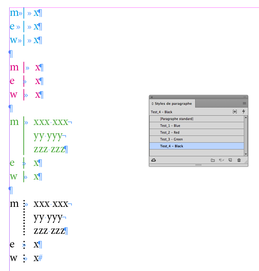

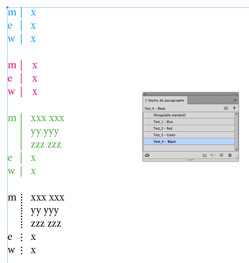

Hi Jane,
The "Test_1 - Blue" para style is the common use in such a case!
The decimal teb is interesting if you totally use it [see my "Test_2 - Red" para style]
The "Test_3 - Green" para style is cool because it will be able to manage a multi-lines para ["Shading" feature]
Finally, the "Test_4 - Black" para style is the most powerful [personalized pipe aspect] using an extra feature provided by "ParagrahBorder" plugin! …

Hi Obi-wan,
As usual, I have learned something from the Jedi.
Starting with #4. I see that I can download the trial and play with it—the borders won't print or export—and then decide if I want to spend $25. Do you use it?
DTP Utils | Products | Paragraph Border
#3
If that's done with shading, I will try to play with that when I am not on my iPad. I like the look of one long line.
#1 and #2
I am not seeing the difference?
~ Jane
Copy link to clipboard
Copied
Jane,
Yes, I use it since its beginning! It's very powerful if you need to have a stroke around parts of text as here (screenshots below).
If the text moves, nothing to do! It's totally automatic.
About the specificity of #2, I use only one tab, not 2. The pipe is included in the decimal tab. It's not the case in your screenshot!
