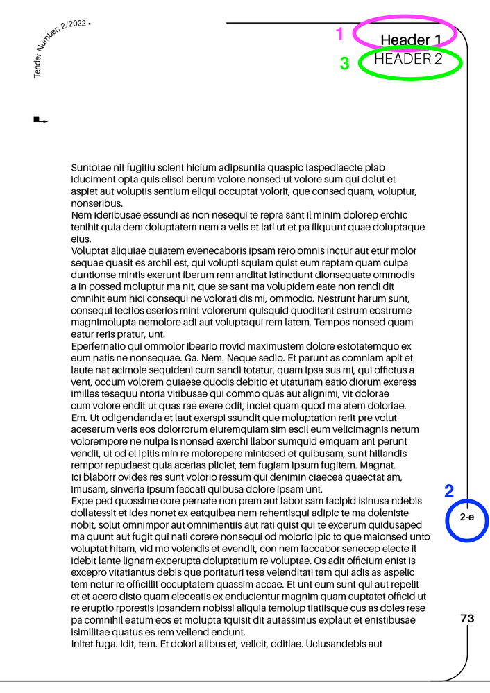

Do you have Text Columns in your document?
Explorer ,
Nov 27, 2022 Nov 27, 2022
I want them in this order: Header 1, Section Number, Header 2 (attached screenshots).
I had to fix the TOC manually for each section because it was showing after Header 2.
Screen Shot 2022-11-27 at 11.49.31 PM.pngScreen Shot 2022-11-27 at 11.53.30 PM.png
LEGEND ,
Nov 28, 2022 Nov 28, 2022
Can you make the BLUE TextFrame to start between MAGENTA and GREEN?
Tall, narrow, text vertical align = bottom.
That way their order will be as you need - the only thing you'll have to do would be to combine paragraphs in the TOC?
And next time include screenshots in you 1st message 😉
