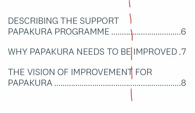

Hi there,
Am setting up a TOC. As I often find, my headings can run on a bit long, which translates to a cramped TOC entry. Specifically, as I sometimes like to run my TOCs in columns, the headers either result in line breaks that leave a 'runt', or just fit in one line, but bunch up hard against my page number - see attached.
My question is: is there a way to specify the end of the line of header text independently of the text box width - apologies thats rather cryptic, but if you refer to the screen grab, what I mean is, can the text be made to line break at the red dashed line, so that the words 'IMPROVED' and 'FOR' would bump to the line below? Result being a look more like the top entry, p '6'....
Thanks for any help.

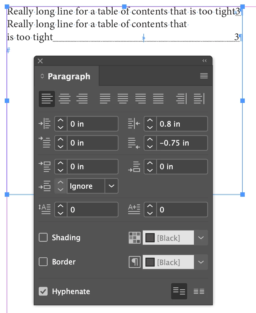

Some strategic adjustment of the right indent and last line right indent should help

Yes, margins, font size, all that. I may have answered at a tangent, but if the issue is getting consistent breaks in the TOC entries, the hard-space gambit should work there as well.
And, of course, althought it's not always an option — just adjusting the length of the header content can help in stubborn situations.
James Gifford—NitroPress
January 17, 2023
Instead of line breaks, make selective use of non-breaking spaces to hold things like headings together in the copy. They won't prevent the lines from running together in a TOC unless they're so long they wrap there, too.
