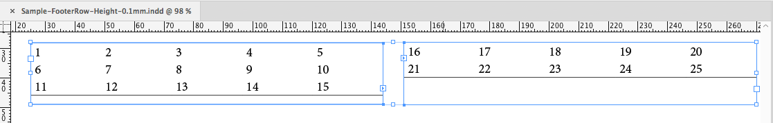

Aug 21, 2017 Aug 21, 2017
Just tested my script snippet with InDesign CC 2017.1 and it's still working.
Below an example where I tried a footer row with a height of 0.1 mm and a bottom stroke with 0.5 pt.
The effective height was 0.114 mm wheras the minimum value was shown as 0.1 mm.
( Seems, that I hit a limit here. )
Uwe

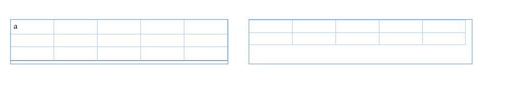

LEGEND ,
Hi Uwe,
Nice!
… Sometimes, use The Force can be more simple … and automatic!
LEGEND ,
What you mean, if I understand well, is, when a table runs on 2 pages [A & B], have a "color" line at the bottom of the first table part [on page A] but not at the top of the second table part [on page B]!
Right?
