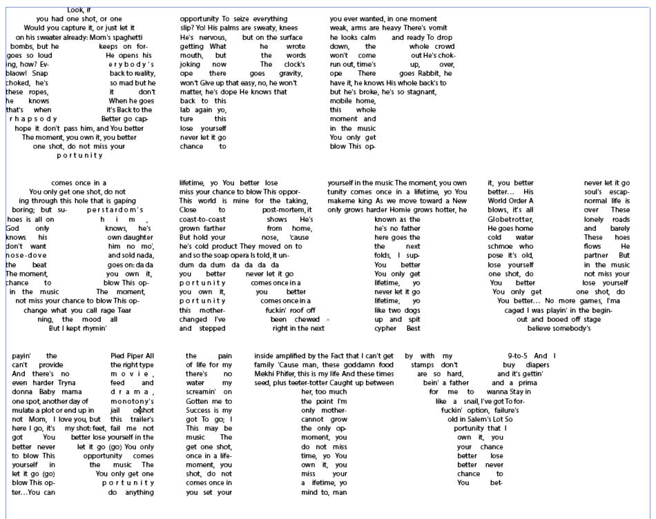

I am hoping someone may be able to assist with this problem. I am trying to fill the text frames with copy. However, as can be seen in the image, some lines are not cooperating with me. There is no formatting on the text whatsoever as it is a straight copy and paste from Notepad with no line breaks.
The text flows fine down the three rows of containers, but I cannot figure out why it is skipping lines in the last container of each row when there is clearly space for the words to fit. All the copy is present, it is just not filling the containers fully.
I have tried in both single line and paragraph composer, single and multiple columns, GREP find and replace, and pretty much everything else I could find, but nothing seems to be working. If I flow the text from frame to frame, then all the frames fill correctly with no gaps, however, I need the text to flow from row to row otherwise it does not read right. It must read like a book across the rows and down. Would anyone here have any clue as to what the problem could be?Capture.JPG

that's a limitation with InDesign's text compositing engine.
Workaround 1:
If you single out every "character" that was converted to path as a separate text frame then it will work.
Right now you are doing this with compositie paths with too many gaps. Four gaps are ok. Five gaps are too much.
Workaround 2: Do that with Adobe Illustrator and place the ai file.

Hi Laubender. That's a bit of a shame the compositing engine has this limitation. Thanks for explaining, at least now I know I can stop smashing head against the wall over it, because it's just not going to happen. I will try the AI route instead. Be well.
