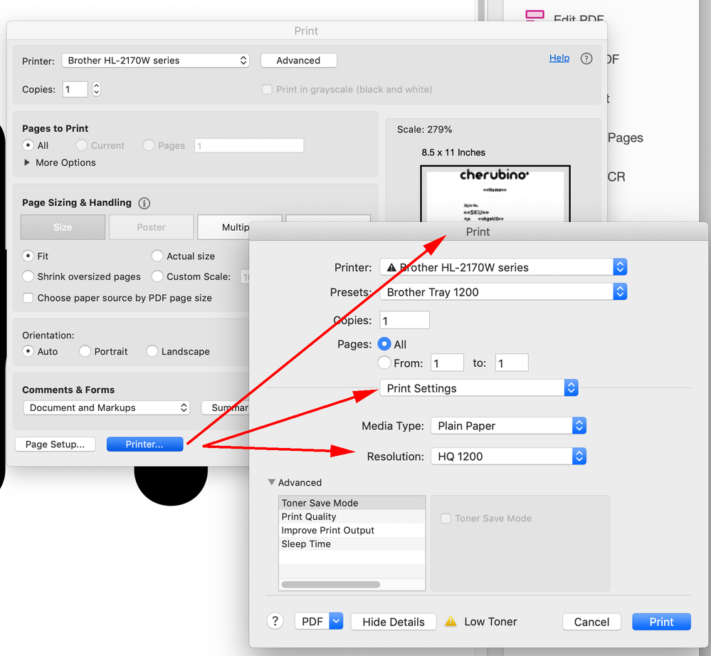

Hi @Globek , Not sure if this is causing the problem, but the placed .eps and .png barcode are RGB and when you export to a Press Quality PDF, the RGB blacks get converted to CMYK—your document has US Web Coated SWOP as the CMYK profile so the text and barcode export as 75|68|67|90 CMYK and not 100% Black:
Also the .eps text has been converted to outlines, which removes the font’s hinting—hinting improves the output of type on low res devices, so the combination of outlining and the 4-color black might be contributing to the poor quality.
You can export a the PDF so that the text and barcode are black only—that might help. Set your Export preset to PDF/X-4 with the Output tab set like this:
That exports the PDF as black only:
Also check the Acrobat Printer... or Print Setup settings to make sure the print driver is set to its highest resolution:
