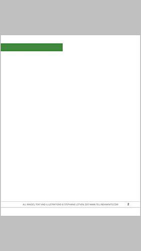

I created a document using InDesign CC 2017 using Mac Sierra. I exported the document as a PDF. I can view the PDF without any problems on my desktop, but many of the recipients are having trouble viewing the PDF on mobile devices or tablets. When they open the PDF, the text and images are gone. They only see my footer and a single shape, like this:

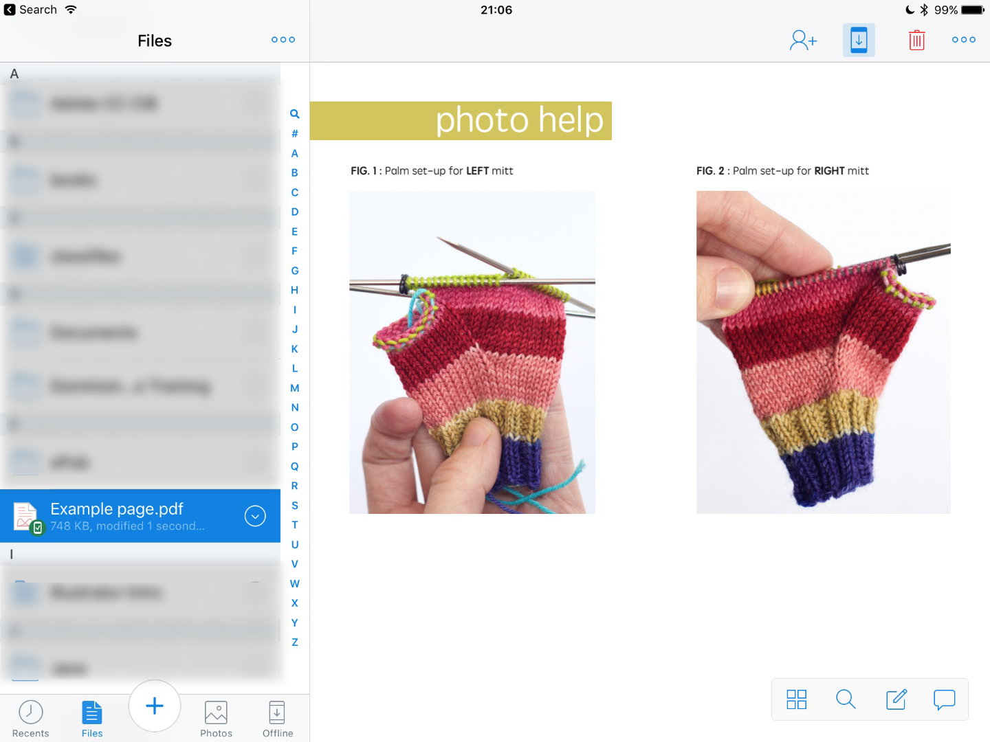

That dark green bar is way off from the color specified in the PDF – in Adobe Reader and in Mac's Preview, the CMYK value "0 0 73 22" displays, rather correctly, as a slightly dirty yellow.
Could it be the iPad's Reader cannot handle the CMYK colorspace correctly? Try exporting your document as RGB and check again.
(The reason I suspect this is the problem and not the text, is because the fonts all check out. In the PDF, I find that the text at the bottom gets drawn first, and indeed it appears normally. After that, the yellow bar ought to be drawn, which appears here as green, and only after that the rest of the text and the two photos are drawn.)

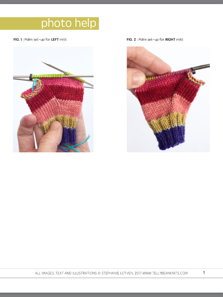

((Quite ironically, as I have a rather old iPad, I don't use Adobe Reader. And the file displays just fine in my old iBooks, with the correct tint of yellow ... Here is a screenshot.))

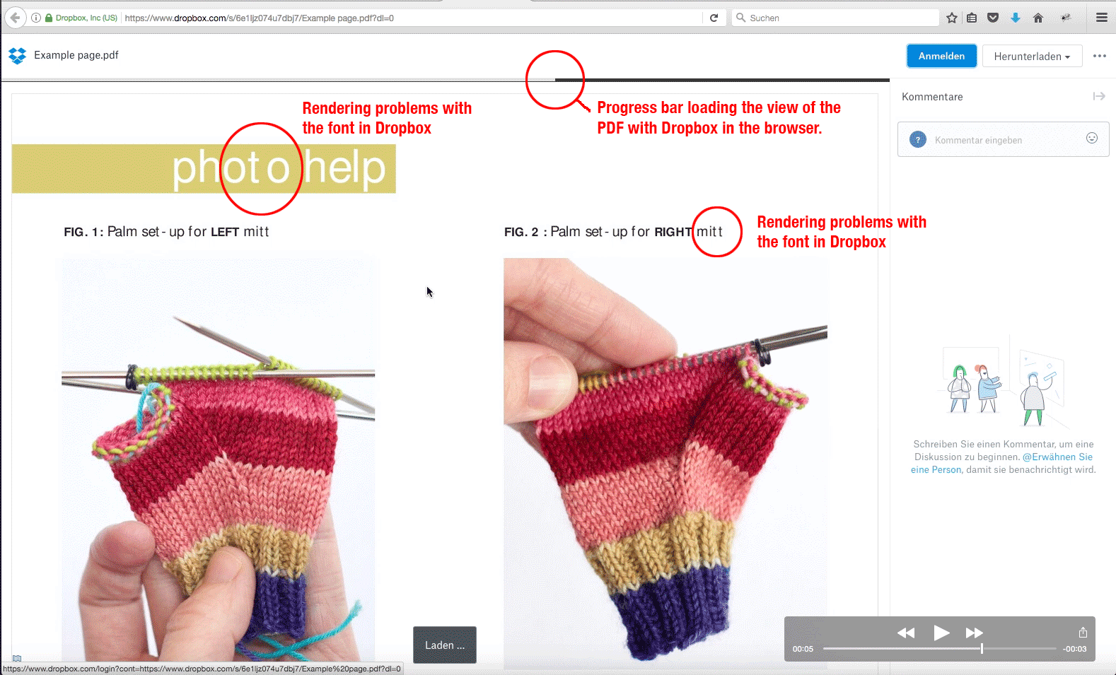

Hi Jongware,
I get different results with HTML/PDF rendering in Dropbox with different desktop browsers like Safari and Firefox on OSX 10.10.5.
As long as Dropbox is loading the rendering of the text is done.
However it's not as good as the rendering with Adobe Reader or Acrobat.
The screenshots are taken from a movie with the Quick Time Player of my Mac OSX.
But after the progress bar has finished the text will vanish:
I also see some quirks with Firefox' own PDF renderer if I open the PDF from my harddisk in the browser:
Uwe

Apr 16, 2017 Apr 16, 2017

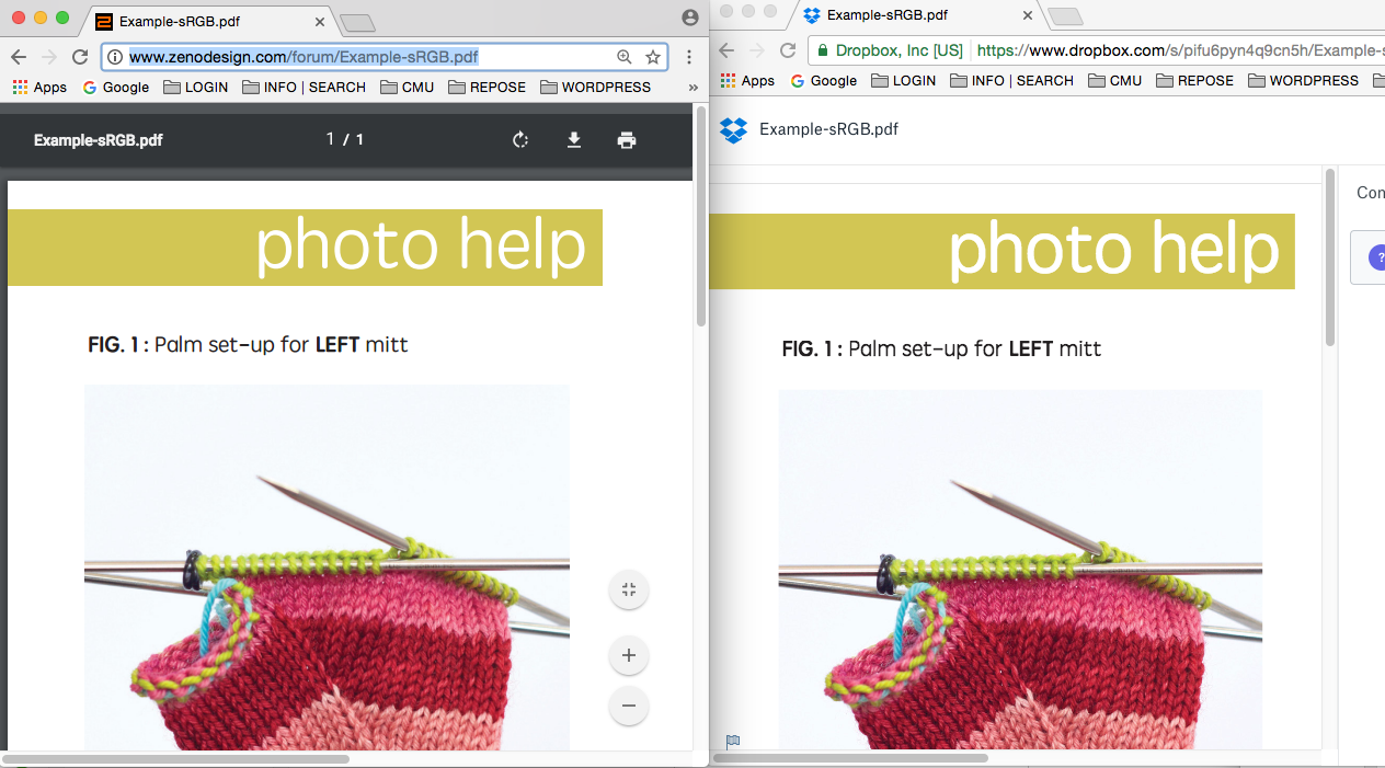

Dropbox does seem to add another variable to the rendering. The flattened sRGB example I posted in Dropbox renders the headline as bold (again after the Dropbox progress bar completes). If I load the same PDF directly from my server in Chrome the headline renders at the correct weight in my server version:
http://www.zenodesign.com/forum/Example-sRGB.pdf
Here's Chrome (the bolding still happens in Firefox)

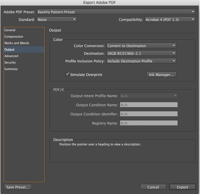

Try exporting with this setup

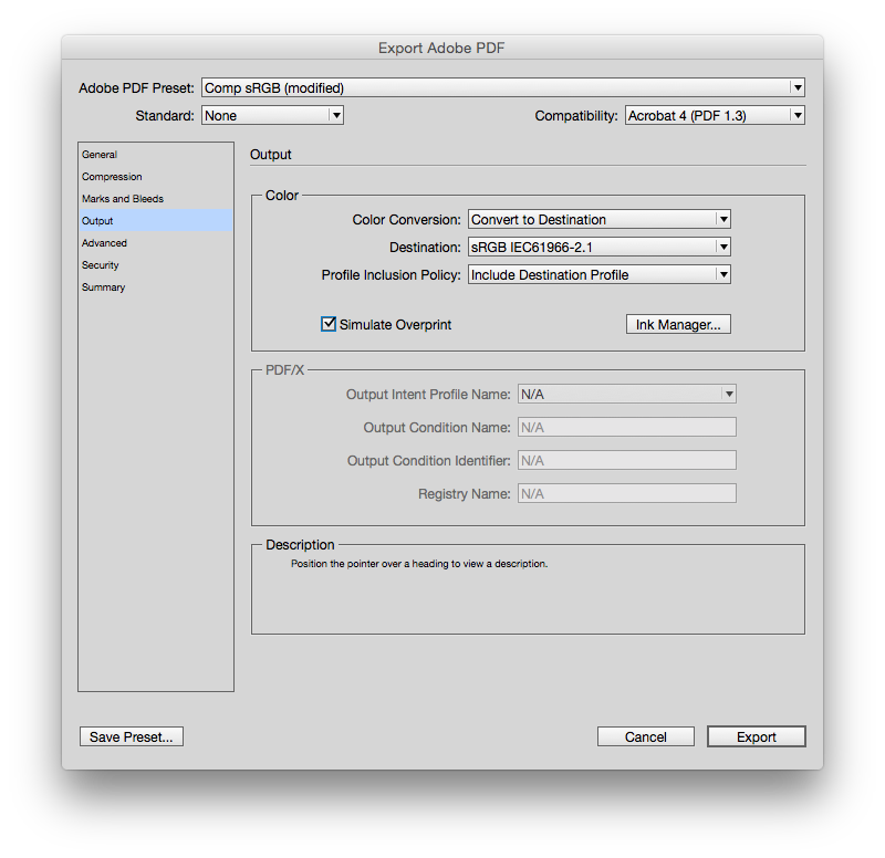

Thank you so much for your help. I am not very software savvy, so please excuse me. When I try to export the file from inDesign as a PDF, I don't have the option for "Comp sRGB (modified)." Here is what I have in this dropdown menu:
What am I missing? Thank you so much for your help. Thank you to everyone for helping me riddle this out.
Apr 17, 2017 Apr 17, 2017
The preset showing in my capture is a preset I saved via Save preset in the lower right corner.
Set the Output tab's settings to match what I'm showing in my #13, and then if you want you can save the settings as a preset that you can load later.

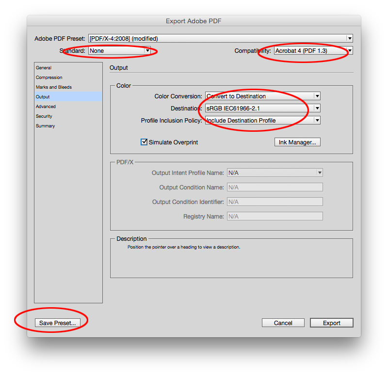

Thanks. I understand that I should be on the Output tab, but once I'm there, I don't have the option to choose "Comp sRGB (modified)" in the dropdown menu (see my image capture in post 17). I only have the Adobe PDF presets shown. How can I add "Comp sRGB" to this menu?
Don't worry about the name of the preset "Comp sRGB" specifically. You can name your own saved presets anything at all that you want. Just match all of the other settings.
Then, optionally, click "Save Preset" in the lower left. Type in "Comp sRBG" or something else that makes sense to you and then it will appear in your list.
Also! "Modified" means it is not using the preset. It means a setting was changed. So don't try to make it say "modified" either.
