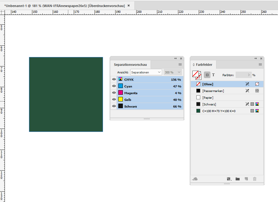

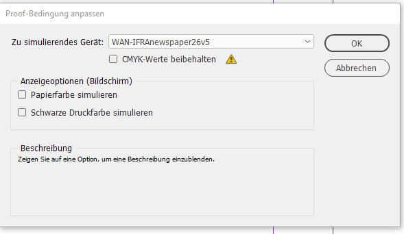

Below a test situation where I used my ISO Coated v2 profile for offset on a new document where I added Dark Green with the offset values, 100c, 70m, 100y, 0k, and a simulation of the WAN-IFRAnewspaper profile for newspaper printing. In the simulation I disabled the option that CMYK values should be maintained ( this option is enabled by default ).
From my German InDesign:
The yellow triangle is a warning that I disabled this option.
Now I switched on the Color Separation Preview and see that the Dark Green is simulated as if its color values changed to 47c, 4m, 40y, 66k. Note: In the screenshot my cursor is in the dark green field:
The results may be differently in your case. It all depends on the used ICC profiles.

Hi Uwe & Greg, I think it’s important to note that using Proof Setup/Proof Colors doesn’t change the native swatch color, it remains as 100|70|100|0 270%. Separation preview is showing the proof simulation numbers for a color conversion made sometime in the future.
Total Ink is only enforced when there is a color conversion, so you would have to use Edit>Convert to Profile to actually convert the swatch into new values that are less than 270%. So here my document’s assigned CMYK profile is the common Coated GRACol 2013 and the fill on the left is 100|70|100|0. On the right is Pantone 350C a Lab value that will not be affected by a document color conversion.
If I convert to the ISO Newspaper v4 26 profile the original CMYK swatch values change:
Total ink is now 171% and the color appearance has been maintained because I set the Intent to Relative Colorimetric
