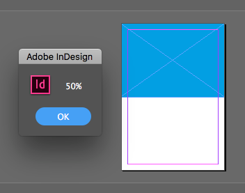

Guide ,
Mar 31, 2023 Mar 31, 2023
Counting the pixels.

This is pretty easy 😉
What if you have cutouts? Objects with clipping path? Or even PDFs with transparency?
Guide ,
The fancy stuff should work. The bleed can be in / ex cluded. Now I need to go find the EU regs.

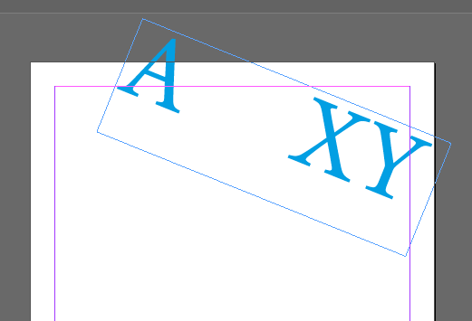

Guide ,
Apr 01, 2023 Apr 01, 2023
Hmmm, the margin is anyting over the pink lines. Currenly I am using this as a clipping path.
LEGEND ,
Apr 02, 2023 Apr 02, 2023
Margin is not a line that limits printing area - page's edge is.
And looking at your example - are you able to calculate area of this text?
Guide ,
Yes, the A and Y would be clipped.
LEGEND ,
But can you get the area of the shape like this??
Guide ,
Yes.
