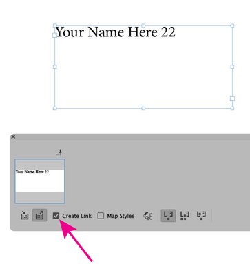

Are you trying to do this on a pdf or InDesign file? If pdf, you can create a pdf form where a text field will duplicate itself if the name of the field is the same, for example when the field is copy and pasted. If InDesign file, another method is to use the content collector tool to copy a text box as a link and paste it where needed, the content of the original text box will appear where ever the link is pasted (it will appear upon link update).

You can use the content tools. With the first one you pick a frame with any content.
Then the convoyer panel appears. Here you see all choosen contestants. Select one, you can choose to link it and with the content placer tool you can place it somewhere else in the same or other document. If you change the original all instances have only to be updated as you would do if you work on another linked asset.
The convoyer panel has some other useful options.

Note that the conveyor or "Paste Linked" requires the link to be updated and may not retain formating.
