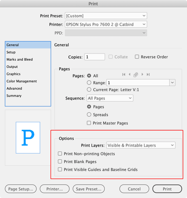

Hi @RickAW , If the printer has a duplex feature it will be accessible from Print>Printer...(Print Setup)
You can see this large format Epson has entirely different Print Settings than the Brother laser printer—the setting are provided by the driver software not InDesign.
BTW I’ve never had a problem gettting high quality prints directly from InDesign—it’s just a matter of sending all data (Graphics tab), and properly setting up the driver options in the Printer... dialog.

Also, many applications take you directly to the OS print dialog with the hardware specific settings—for example Apple’s pages:
But Pages and other apps are relatively simple and don’t have application specific print requirements. With InDesign you might need to print Separations, Printer Marks, include or not include bleeds, print spreads or single pages, etc. The set of InDesign specific print options is quite large, so there is an application specific dialog separate from the print driver dialog:
