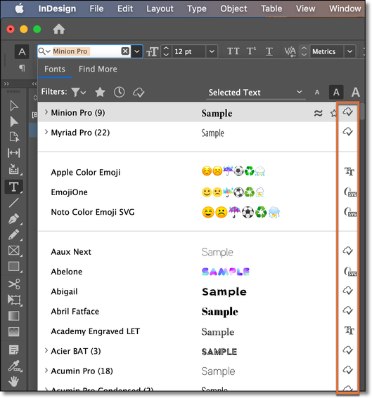

Hi @JoAnn H:
You can see the type of fonts you have installed by examining the right column in the fonts list. All of the Adobe fonts that come with your CC subscription (cloud icon or O) are OpenType fonts. TT designates TrueType. You will see a T1 by the Type 1 fonts. I don't have any installed at this point so I can't show you one in my list. Specialty fonts come in all varieties. For classroom lessons they can use whatever they like. For professional print jobs I'd encourage the use of Ope

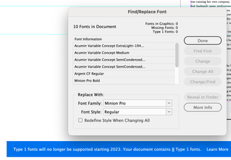

Thank you for this explanation. I am getting an error that says my document has 43 type 1 fonts in it. We use only two fonts in our magazine. So gulp! When using your above method, it says "Open Type Type1" and has an extension of .otf. I am assuming these are fine, but why am I getting this scary error? Thanks!
May 06, 2022 May 06, 2022
Have you updated InDesign to 17.2.1?
"43 type 1 fonts"
Hi Steve,
could you show a screenshot of your Find/Replace Font panel where the used fonts of the document are listed?
At the top of the panel you'll find the number of Type 1 fonts. In Brad's case it says Type 1 fonts: 1.
FWIW: If you did not update to InDesign version 17.1.0.50 or above you will perhaps get a false warning with that blue banner. Depends on the history of Type 1 fonts used in this document.

Hi @JoAnn H:
You can see the type of fonts you have installed by examining the right column in the fonts list. All of the Adobe fonts that come with your CC subscription (cloud icon or O) are OpenType fonts. TT designates TrueType. You will see a T1 by the Type 1 fonts. I don't have any installed at this point so I can't show you one in my list. Specialty fonts come in all varieties. For classroom lessons they can use whatever they like. For professional print jobs I'd encourage the use of OpenType fonts.
You can check an existing document for Type 1 fonts by opening Type > Find/Replace Fonts. type2.png
Type 1 warning upon opening, but find/replace says there isn't a problem. Type 1 when saved to PDF. Help!

I have a document that uses Helvetica Neue Lt Std Family only. In Font Book it is OTF and in InDesign Find/Replace Font my T1 fonts show up as 0 but still getting the Type 1 warning like gwynk.
Do I have a problem I didn't think I had, is this something I need to fix?
Jan 31, 2022 Jan 31, 2022
You'll be fine. The algorithm that is in ID 17 when it was released is a bit more aggresive than previous versions (yet at the same time pretty uninformative), in that it's finding old historical references to Type 1 fonts in a buried XML section of your document. If you are showing zero Type 1 in your Find/Replace, then that's accurate. Unless there's an errant Paragraph/Character style that is using an Type 1 font, but even those should show up in the Find/Replace. The latest version (ID 17.1 rolling out now) has apparently tweaked the algorithm,, but in the meantime, you can click "Remind Me Later" to dismiss the blue warning.

Hi together,
the update to InDesign 17.1.0.50 should fix the issue with false warnings of used Type-1-font styles.
I only tested with a small amount of documents that would have triggered false warnings when used with 17.0; as far as I can see and test for now, the issue of false warnings is gone.
