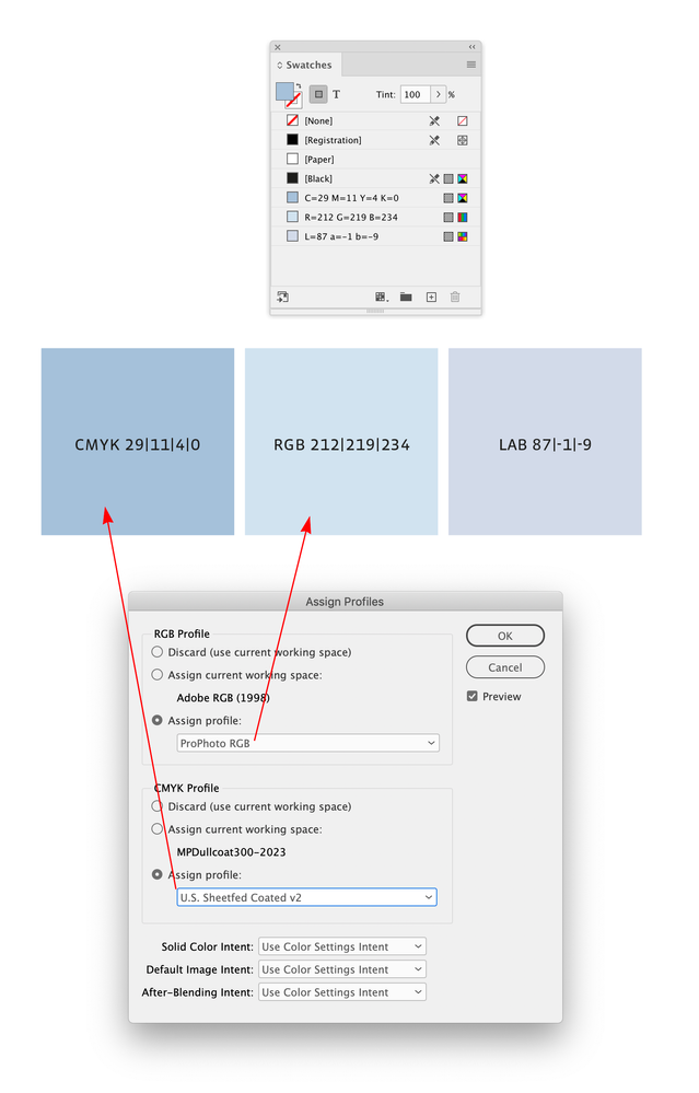

Hi Peter, Yes hex is just a different RGB notation. I get #D4DBEA for 212|219|234 in InDesign, Photoshop, and via math. The chart in @dagingen ’s clip is a bit blurry, but seems to be listing #D4DBEB for 212|219|234, which I don’t think is right.
Also the chart is showing CMYK 29|11|4|0 and RGB 212|219|234 (#D4DBEA) as colors with a matching appearance. I can’t find any CMYK and RGB profile combination that come close to displaying a match, so I’m guessing the chart values are from some website conversion and are not color managed conversions.
A few profile combinations for the 2 values:

Also, InDesign’s color conversions are color managed, so the conversion from a set CMYK value to RGB would produce different values depending on the document’s assigned RGB and CMYK color profiles, and the current Color Settings’ Conversion Options Intent.
Looks like the chart you are using is not color managed, and assumes some unknown CMYK and RGB color space for its conversions.

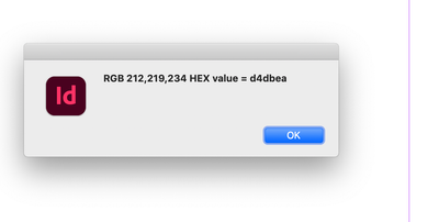

Hi @dagingen , I think InDesign’s hex value for RGB 212|219|234 (#d4dbea) is correct. The math to get the 16-bit hex values can be scripted:
var ca = [212,219,234]
alert("RGB " + ca.toString() + " HEX value = " + rgbToHex(ca))
function rgbToHex(c){
    var hs = "";
    for (var i = 0; i < c.length; i++) {
        var hex = Number(c[i]).toString(16);
        if (hex.length < 2) {
            hex = "0" + hex;
        hs += hex;
    return hs;
Returns this:
Photoshop also returns #d4dbea for 212|219|234:
